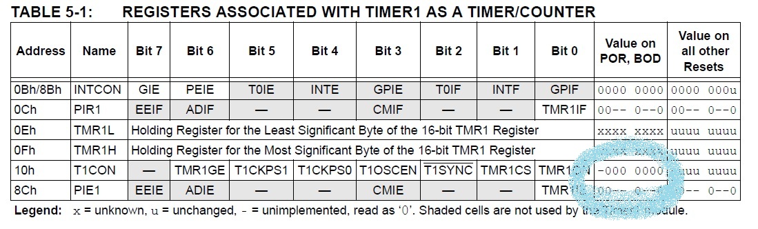

    Default Re: How to set GPIO.5 as output ?
    You realize the T1CON.3 BOD /POR is 0 by default . . .
    Name:  12F675 T1CON.jpg
