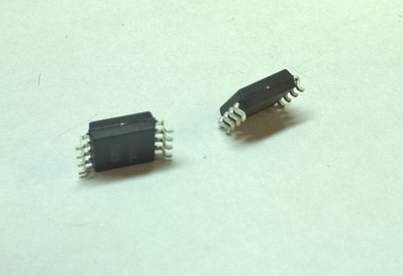

Once removed use some solder wick to remove the excess solder from the pads. Tip: solder wick oxidise with time: apply a little flux before using. If you have the wide chip you'll have to bend a little the pins.
