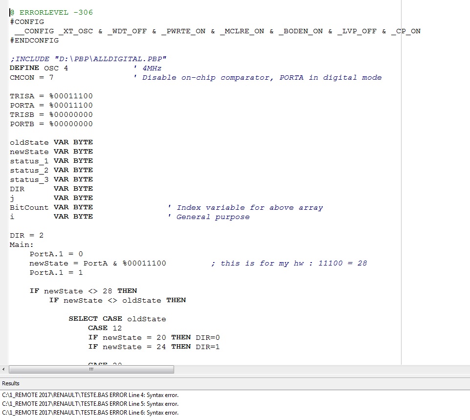

    For me the solution don't work ? Any others sugestions ? Thanks !

    It doesn't work for you because you have not applied the solution. Read the thread again.

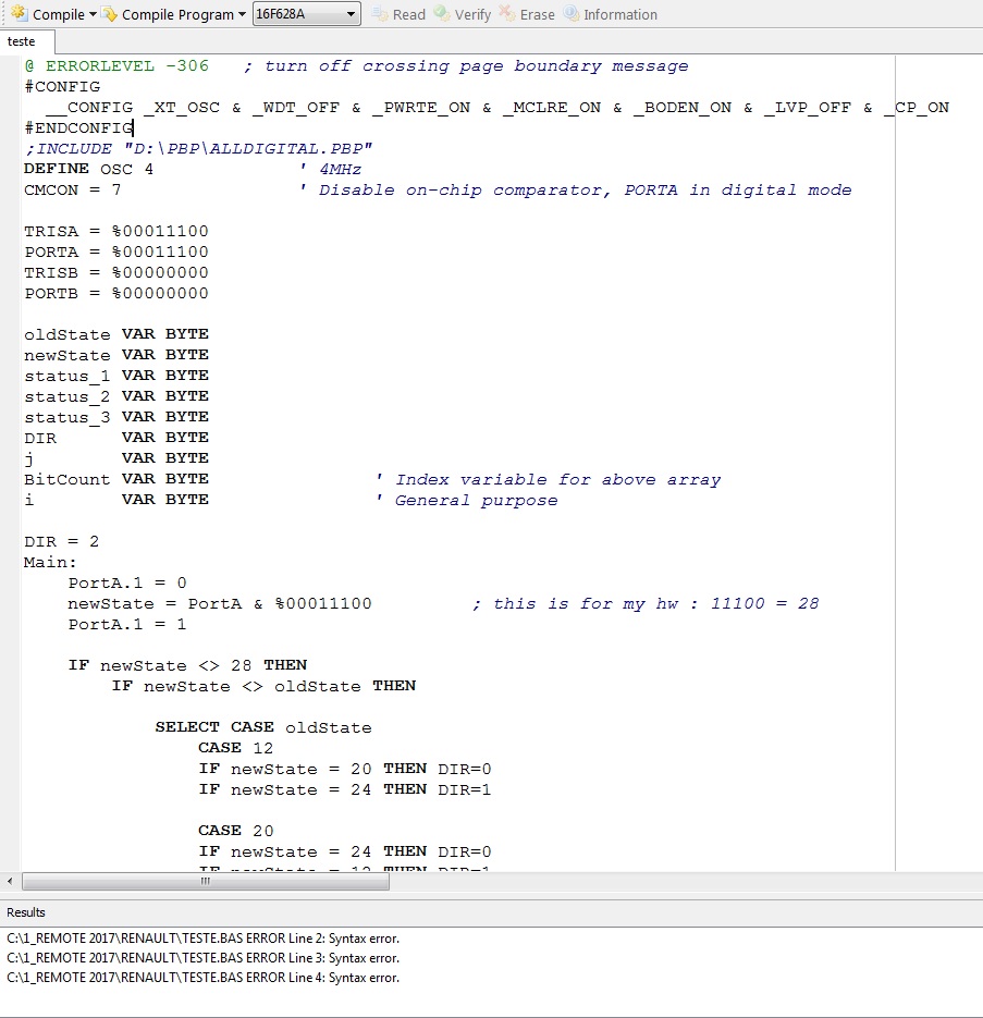

    Thanks for fast reply !
    But ... I don't understand what I do wrong ...
    I wrote :
    @ ERRORLEVEL -306
    __CONFIG _XT_OSC & _WDT_OFF & _PWRTE_ON & _MCLRE_ON & _BODEN_ON & _LVP_OFF & _CP_ON
    Exactly like in post #3.
    Default Re: Error Compiling with PbP 3
    But that's not the same code - or error - as in your previous post now, is it?
    Now you've fixed the "Overwrting previous address" error and you're facing a completely different issue.
    First try commenting out the Include statement to see if the problem is within that piece of code.
    Then please post the code, within code tags, so we don't have to retype it and make our own errors.

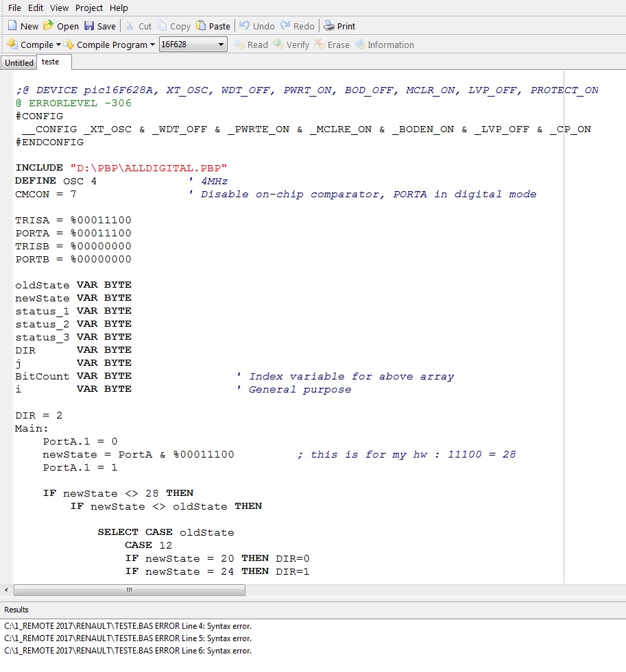

    No change !

    @ ERRORLEVEL -306
    ;INCLUDE "D:\PBP\ALLDIGITAL.PBP"
    DEFINE OSC 4             ' 4MHz
    CMCON = 7                ' Disable on-chip comparator, PORTA in digital mode
    TRISA = %00011100
    PORTA = %00011100
    TRISB = %00000000
    PORTB = %00000000
    oldState VAR BYTE
    newState VAR BYTE
    status_1 VAR BYTE
    status_2 VAR BYTE
    status_3 VAR BYTE
    DIR      VAR Byte
    j        var byte
    BitCount VAR BYTE           	' Index variable for above array
    i        VAR BYTE           	' General purpose
    dir = 2
        PortA.1 = 0
        newState = PortA & %00011100         ; this is for my hw : 11100 = 28
        PortA.1 = 1
    You seem to have the 628 selected in one of the screenshots, and the 628A in the other.
    Which device is teh code INTENDED for and which device do you have selected in the dropdown list?
    /H.
    Sorry, is 16F628A !
    Well, then there must be some hidden character in there because if I copy/paste the code from post #10 above and compile it for a 16F628A it works just fine.

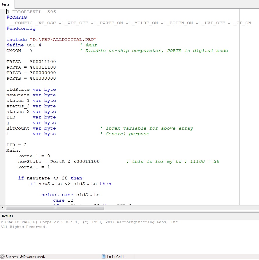

    Don't know how...but solved. Thanks !
