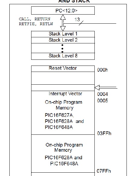

    Name:  memory chart.jpg
    16f627A memory only go s to $03FF so I would check to see that you have the correct chip selected in your compiler when you make the HEX file

    The picture I posted above is from the data sheet showing the memory map of that series of chips, and indicating that 16F627 has NO MEMORY beyond 03FFh . That is why I submitted my response. If you have a 16F648 or 628 I would bet the hex would go in. Perhaps your programmer is set to one of those chips? The 16F648 has Twice the program memory of the 16F627 and otherwise mostly the same. As you have posted NO CODE I / we are unable to diagnose your problem further. PBP usually complains at compile time if you write more code than the chip will accept.
