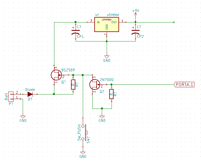

    I have A circuit that looks like this and all works as expected.
    But I´m not sure if the BS250 can handle the two capacitors i the long time, I assume that the BS250 will be shorted for a short time when the button is pressed and the C1 and C2 are empty?
    C1 - 1uF
    C2 - 2,2uF
    Power source - 9v battery

    Pushing the button sends the gate low (BS250), but I don’t see how it directly shorts
    C1,C2, or anything else. R? prevents a direct short in any case as far as I can see.
    Default Re: Circuit question
    looks to me like the pushbutton 'closes' the P channel fet , charges the caps and putting PortA1 high keeps circuit going until PortA1 goes low, BS250 opens and the caps drain.... ??

    I went here to see how much in-rush current you can expect and understand your concern about that BS250 part limited at 180mA. The data sheet doesn't even provide pulse current parameters.
    I would upgrade to a another P-CH FET with a much lower ON resistance in the low 100's of milli-Ohms that can easily handle the short burst for peace of mind.

    Quote Originally Posted by LinkMTech View Post
    In this datasheet from the place I bought the part http://www.electrokit.com/productFile/download/4175
    it say´s something about "Pulsed Drain Current IDM =-3 A
    But I don't understand what they meaning with -3A?

    In short, it's the current leaving or supplied through the Drain as the case with the P channel. Electron flow verses Hole flow theory, depending on your upbringing.
    So the 3 Amp rating in the 300us pulse test is more than adequate since the initial cap charge of ~640mA is over very quickly, less than 40us, then tapers off from there.
