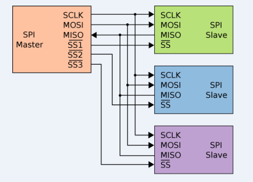

    Hmm, I'm not sure about that. I know that SDI (Master) goes connected to SDO (Slave) and SDO (Master) goes to SDI (Slave). But, a quick search in Google for SPI wiring will bring you some circuits like this,
    As you can see MOSI goes to MOSI and MISO goes to MISO. . I am trying to connect my PIC to an NFC module that only accepts SPI. The ports of the module are labeled as MOSI, MISO, SCK, and SSEL. I haven't had any luck getting a response from the module yet. Can I use SHIFTIN and SHIFTOUT in this case?

    you will need to refer to the docs of your nfc module to verify what is an input and what is an output to be sure. as a general rule inputs connect to outputs , connecting outputs together is bad and connecting inputs together is going to go nowhere
