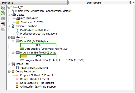

    Default Re: Version 3.0.8 released.
    Code folding and RAM doesn't work in MPLABX, it just show how much FLASH is used.
    Used RAM is always 0%

    I have used mplabx for pbp3 in the past and find
    1. code folding does not work
    2. ram usage is always 0
    3. it won't complie with dt-ints18 included
