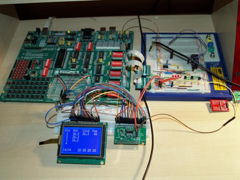

    Current PIC is an 18F4580. I use the standard serial comms to communicate with a PC applications. I'm developing the project to include additional sensors and as such need more real estate to display the results, so I've obtained a 128 x 64 FLCD, which with a similar font to an LCD, gives me 7 x 21 characters which is ideal.
    I've also puchase a serial / i2c / SPI piggy back driver for the display, and at the moment have it running in serial mode as it was not wanting to do much more than control the back light etc. If I can get this running under i2c it would free up the TC/RX pins for either serial connection with the PC or the use of a serial wi-fi board mentioned above.
    However I have 4 lines of code which simply fail to compile following the conversion from serial to i2c
    i2cwrite SDApin,SCLpin,$00,$42,"TP",DEC1 Pid_channel+1,0

    But again, work fine when HSEROUT is used inplace of i2cwrite....
    I think I'll skip the i2c conversion and carry on with the stock serial version, and try and get the rs232 to USB board working with the GLCD driver board.

    Well after a lot of head scratching I have it working. No matter what I tried it still work and kept halting - Off board Tabsoft stated it worked fine for him using PBP3 so I downloaded the 15 day trial, confirmed it worked, but then as it screwed up my pbp2.60 setting, un-installed it and pointed MSC back at the PBP2.6 folder... tried again and it worked (WT* and other expletives filled the air at this point)
    Anyway, just to clear things up, I now have the GLCD running via a driver board using PORTB.0 and software serial commands (SEROUT2) and the PC application communicates with the PIC via an FTDI chip on the PICs hardware UART - and it updates juts fine
    Rightt onto the next part of tidying up the menus before replacing the FTDI chip with an ES8622 Wi-Fi module - stand by guys, no doubt I'll have a few more questions for you.
