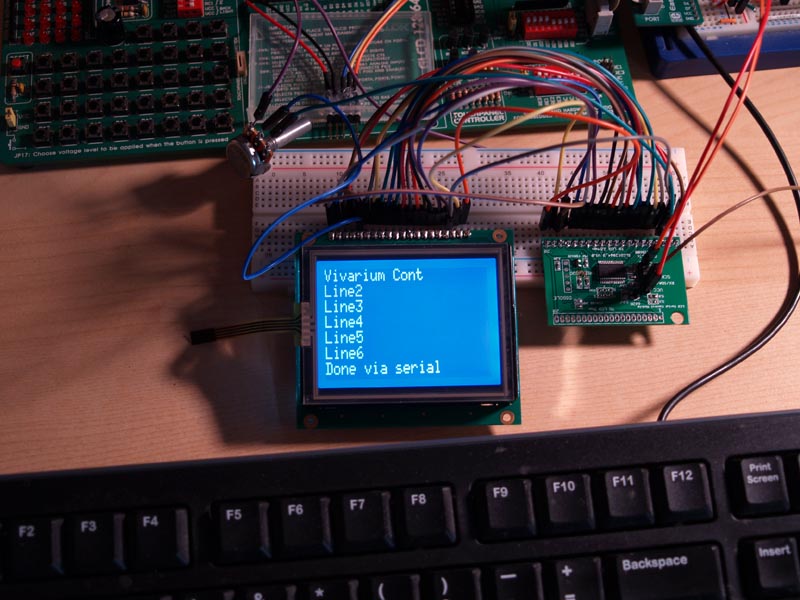

    Would welcome suggestions as to how to configure this puppy to use it's internal fonts to give me the equivalent of an 8 x 20 LCD as I've not only gone grey with this, but now getting bald
    Oct 2009
    583
    Default Re: Sending text to GLCD using BV4511 interface
    Ok I gave up with the BV4512 board and the I2C connectivity of the Digole board, and stested the Digole board in default serial mode.
    It took a while but it works.
    Having the built in selectable fonts makes this behave as if it was a large LCD - which for now is what I'm after.
