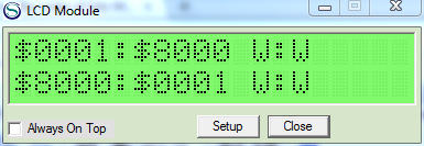

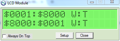

    I tried the operator "REV" and it doesn't seem to work as expected.
    The following snippit displays what I would expect.
    myWord var word
    myTest var word
        Low PORTE.2       ' LCD R/W low = write
        Pause 10         ' Wait for LCD to startup
       lcdout $fe, 1
       myWord = $1
       myTest = myWord rev 16
       lcdout $fe, $80, ihex4 myWord, ":",ihex4 myTest," ","W:T"    'Store reversed value in separate var
       myWord = $8000
       lcdout $fe, $c0, ihex4 myWord,":",ihex4 myTest," ","W:T"    'Store reversed value in separate var
       lcdout $fe, 1
       myWord = $1
       myWord = myWord rev 16
       lcdout $fe, $80+6, ihex4 myWord, " ", "W:W"    'Store reversed value in same var
       myWord = $8000
       lcdout $fe, $c0, ihex4 myWord, ":"
       lcdout $fe, $c0+6, ihex4 myWord, " ", "W:W"    'Store reversed value in same var
    Display

    Default Re: Need to flip order of bits MSB to LSB re: MCP23S17
    Here's a few tips
    First off, don't REV anything. That's only going to confuse the issue.
    The MCP23S17 expects the bytes to be sent MSB first, that is the first bit clocked out appears at GPx7 and the last bit appears at GPx0.
    That's what you should get if you specify MSBFIRST in the SHIFTOUT instruction
    SHIFTOUT SDO, SCLK, 1, [databyte]
    If you need to reverse the bits at the output port, then specify LSBFIRST in the SHIFTOUT instruction
    SHIFTOUT SDO, SCLK, 0, [databyte]
