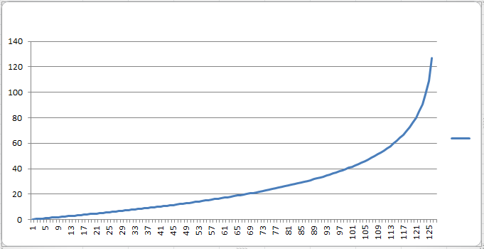

    I'm using ADCIN on a linear analog pot to generate a number 0 - 127. This number is used to simultaneously control several 100k digital pots. Unfortunately, one of the digital pots needs to be linear taper....or I should say, its optimal taper would be linear. And I'm not so good with the math and logarithmic equations and such.
    Could someone please help me with the formula to create a taper that approximates the line in graph "TAPERS A SERIES" found here: http://www.taiwanalpha.com.tw/englis...p_e_106_10.htm

    For "only" 127 values I'd probably go with a lookup table. Perhaps something like:
    Lookup LinValue, [0,0,0,1,1,1,1,1,2,2,2,2,3,3,3,3,4,4,4,4,4,5,5,5,5,6,6,6,7,7,7,7,8,8,8,8,9,9,9,10,_
    10,10,11,11,11,11,12,12,12,13,13,13,14,14,15,15,15,16,16,16,17,17,18,18,18,19,19,20,20,21,21,21,22,_
    22,23,23,24,24,25,26,26,27,27,28,28,29,30,30,31,32,32,33,34,35,35,36,37,38,39,40,41,42,43,44,45,46,_
    47,48,50,51,53,54,56,58,60,62,64,67,69,72,76,80,85,91,98,109,127], LogValue
    Name:  Log lookup.PNG
    Default Re: formula for converting linear taper digital pot to audio taper
    Attachment 7825
    Ah, yes! That makes perfect sense. Thank you, Henrik.
