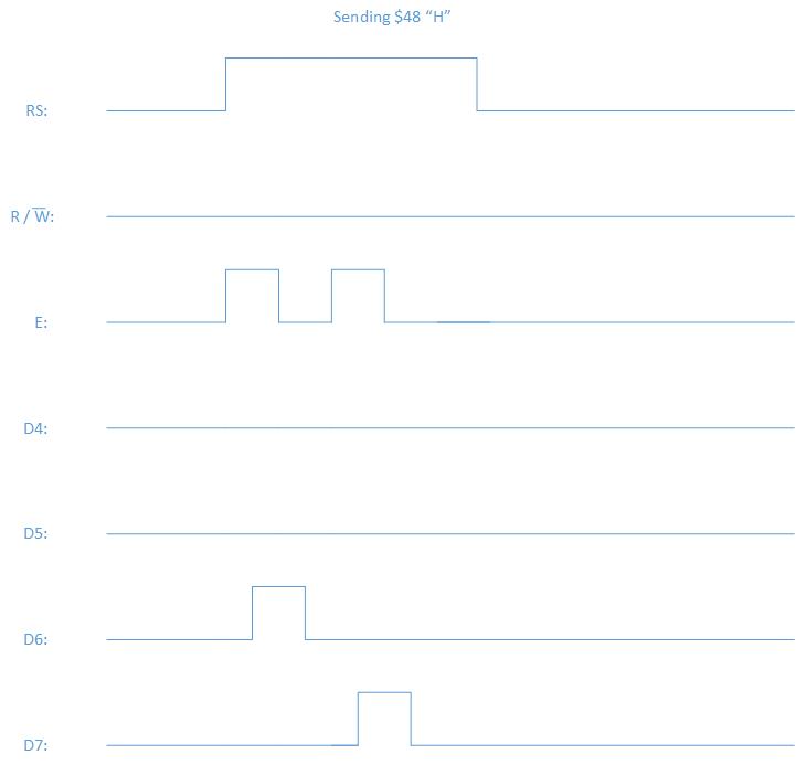

    What are you getting on the RS pin?
    Also have you checked the LCD's VDD pin to make sure it is at least 4.5V?
