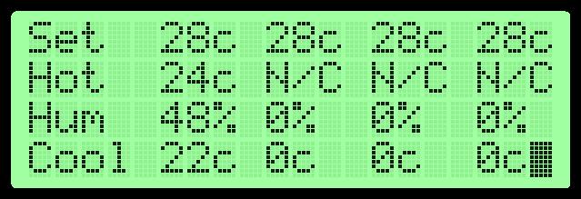

    Default Re: Delay without using pause
    This was the best match, but I have no room to display the time.

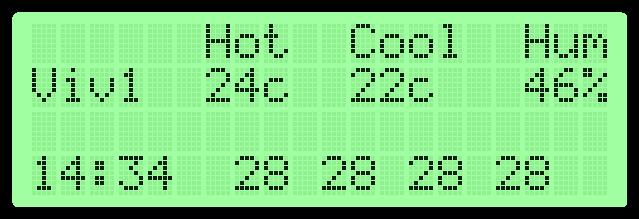

    This is what I'm trying to achieve
    With line 2 being updated with data for Viv2, Viv3 etc

    "which would overwrite the values for each vivarium every few seconds. “
    It sounds like you just need to overwrite the appropriate value into the 4 line buffer instead of updating the whole display buffer for every variable,
    or update the LCD location directly, but I would do the former, and write a complete screen every time.

    The two subroutines that deal with displaying the non presence of a 18B20 and read the AM2302
    ;----[Display Sensor Error]-------------------------------------------------
    ShowError:
        LOOKUP pid_Channel,[5,9,13,17],Bvar               ; Find location;LOOKUP pid_Channel,[$83,$C3,$8B,$CB],Bvar [$80,$C0,$89,$C9]
        LCDOUT $FE,$C0+Bvar,"N/C"           ; print to LCD ;LCDOUT $FE,Bvar," N/C    "
    ;----[Read humidity sensor]-------------------------------------------------
    read_dht:
    for loopcount = 0 to 3
        AM2302_Sensor_Num = loopcount+1
        gosub AM2302_Read
        LOOKUP loopcount,[5,9,13,17],Bvar       ; Find location  [$80,$C0,$89,$C9]
        LCDOUT $fe,$94,"Hum"
        LCDOUT $fe,$94+Bvar,dec AM2302_Hum/10,"% "' ".",dec AM2302_Hum//10,"% "         ; print to LCD
        LCDOUT $fe,$D4,"Cold"
        LCDOUT $fe,$D4+Bvar,dec AM2302_Temp/10
        lcdout $DF
    next loopcount

    You were saying if the program is allowed to go it’s hardest the temps change so fast you can’t read them,
    and your mock display only shows integer values which means the sensor moves back & forth several entire degrees each reading?
    If you let it go with no unneeded pauses, how many times would you guess the LCD is updated in one second?
    To clarify, you check for death temperatures, and print to LCD straight after, so the temps are degrees C by that time?
    That would be a good place for a FIFO buffer to store several previous values for averaging.
    From what I understand the problem, if you had no deliberate pause statements,
    everything would be great if the temp sensors didn’t give values all over the place
    because even thought the LCD updated fast the temps wouldn’t change much?
    Oct 2009
    583
    I discovered what was happening. As I only have one DS18B20 used for testing, the code was running the fore next loop to read the sensors and then printing them to the screen, but as the last three were not fitted it would jump out to the sensor error and display N/C for the for vivs 2, 3 and 4. I also removed the decimal for the temps and humidity simply to make things fit on the display.
    In trying to get the LCD to display the data for viv 1 for a few seconds, then viv 2 etc I tried using case statements, and the Cvar as a counter. The idea being if the counter is between 1 and 10 it jumps to a case statement which displays data for viv 1, if it's between 11 and 20 viv 2 etc. Again that didn't work because it had to be a sub routine in order to jump back and test for sensor error.
    The problem I have in using pause statements is in order to maintain stable temperatures in the vivs, the original code was designed to run through the reading of the sensors, calculating the PID (which was based on real life testing to calibrate the values) and drive the heaters. This works well and I would like to retain that precision, and any pause statements end up delaying the read, display and update process which means the precision is lost.
    The DS18B20 and AM2302 are precise to within 0.5c so the data is stable. As we are only talking + or minus a degree or so being the difference between the PID pulsing correctly or being fully on or completely off, any delay between the read sensor cycle could mean that the heater stays on longer and the temperature overshoots. The result would be that the swing between pulses would be similar to a standard on/off thermostat rather than a pulse proportional one.

    I have it working to a degree, and test so far are encouraging
    Here's the main code
    ; *****  MAIN PROGRAMMING LOOP *****
    if Cvar >12 then Cvar=0
    LCDOUT $fe,$80+5,"Hot",$fe,$80+10,"Cool",$fe,$80+16,"Hum"
    Cvar=Cvar+1
    SetPoint1 = normtemp1
    SetPoint2 = normtemp2
    SetPoint3 = normtemp3
    SetPoint4 = normtemp4
    gosub FlushBuffer:
    If SetButton=0 then                             ; jump to programming
    Gosub SetButtonRelease
    goto mainmenu
    If DecButton=0 then
    goto lightoveride                               ; manual overide of light
    If IncButton=0 then
    goto cancelalarm                                ; manual overide of alarm
    gosub displaytime                               ; update the clock and display the time
    FOR pid_Channel = 0 TO 3                        ; cycle thru all sensors
        GOSUB SelectSensor
        GIE = 0                                     ; disable interrupts before 1-wire
        @  DS1820_Convert                           ; start a temperature conversion
        GIE = 1                                     ; enable interrupts after 1-wire
    NEXT pid_Channel
    FOR TempWD = 0 TO 1000
        IF RCIF=1 THEN GOSUB coms                   ; Check to see id PC application connected
        PAUSE 1
    NEXT TempWD
        GOSUB SelectSensor
        DS1820_Error = 0                            ; clear any previous errors
        DS1820_Flags = 0                            ; clear status flags
          @ DS1820_Stat                             ; check the sensors status
        PAUSEUS 20
        IF !DS1820_Done THEN SensorError            ; if it's not done by now, error
          @ DS1820_Read                             ; get the temperature result
        GOSUB Check4Zeros
        DS1820_Flags = 0
          @ DS1820_Stat
        IF (DS1820_Error = 0) AND DS1820_Done THEN  ; if there were no errors
            Temperatures(pid_Channel) = TempC
            pid_Error = SetPoints(pid_Channel) - TempC
            GOSUB PID
             IF pid_Out.15 THEN pid_Out = 0         ; only keep positive values
             IF ChannelPWR(pid_Channel) THEN
                HeaterDrives(pid_Channel) = pid_Out
                HeaterDrives(pid_Channel) = 0
    IF Temperatures(pid_Channel) >  alarmhigh(pid_Channel) and Alarm = 1 then AlarmPin = 1
    IF Temperatures(pid_Channel) >  alarmhigh(pid_Channel) and Alarm = 0 then AlarmPin = 0
    IF Temperatures(pid_Channel) <=  alarmhigh(pid_Channel) then AlarmPin = 0
    IF Temperatures(pid_Channel) <=  alarmlow(pid_Channel) then AlarmPin = 0
    if Temperatures(pid_Channel) < alarmlow(pid_Channel)  and Alarm = 1 then AlarmPin = 1
    if Temperatures(pid_Channel) < alarmlow(pid_Channel)  and Alarm = 0 then AlarmPin = 0
        SensorError:
               HeaterDrives(pid_Channel) = 0            ; turn off heater if sensor's bad
               SensorActive(pid_Channel) = 0
    NEXT pid_Channel
    If Cvar >=1 and Cvar <=3 then GOto  ShowLCD1
    If Cvar >=4 and Cvar <=6 then GOto  ShowLCD2                                      ; display info on LCD
    If Cvar >=7 and Cvar <=9 then GOto  ShowLCD3
    If Cvar >=10 and Cvar <=12 then GOto  ShowLCD4
    check:
    ;   check lighting periods and turn lights on or off accordingly
        fn = 0                                                      ; select the first Lights
        if lightover = 0 then GOSUB CheckTimes                      ; if manual override set to off then go compare the programed period
        if lightover = 1 then progON=1                              ; if manual override flag set to on then lights on flag set to 1
        IF ProgON THEN                                              ; If in the program period
           IF Lights1 = 0 THEN Lights1 = 1
           IF Lights1 = 1 THEN Lights1 = 0
        fn = 1                                                      ; select the second Lights
        if lightover = 0 then GOSUB CheckTimes                      ; compare the programed period
        IF ProgON THEN
            IF Lights2 = 0 THEN Lights2 = 1
            IF Lights2 = 1 THEN Lights2 = 0
    ;   Check for night time drops - if condition matched, drop temp
        fn = 0                                      ; select the first setting
        GOSUB CheckTimes2                           ; compare the programed period
        IF ProgON2 THEN
        SetPoints[0]=Droptemp[0]                    ; change the corresponding set point to the drop temperature
        SetPoints[0]= normtemp[0]                   ; change the corresponding drop temperature to set point
        fn = 1                                      ; select the second setting
        IF ProgON2 THEN
        SetPoints[1]=Droptemp[1]                    ; change the corresponding set point to the drop temperature
        SetPoints[1]= normtemp[1]                   ; change the corresponding drop temperature to set point
        fn = 2                                      ; select the third setting
        IF ProgON2 THEN
        SetPoints[2]=Droptemp[2]                    ; change the corresponding set point to the drop temperature
        SetPoints[2]= normtemp[2]                   ; change the corresponding drop temperature to set point
        fn = 3                                      ; select the fouth setting
        IF ProgON2 THEN
        SetPoints[3]=Droptemp[3]                    ; change the corresponding set point to the drop temperature
        Setpoints[3]= normtemp[3]                   ; change the corresponding drop temperature to set point
    ; *****  MAIN PROGRAMMING LOOP END *****
    GOTO Main
    And here are the four LDC routines
    ShowLCD1:
       Pid_channel=0
        LCDOUT $FE,$C0,"Viv",DEC1 Pid_channel+1," "         ; print to LCD
        TempC = Temperatures(pid_Channel)
        gosub read_dht
        LCDOUT $FE,$C0+5
        TempWD = TempC : GOSUB TempToLCD                ; display TempC
        LCDOUT $DF
        if SensorActive(pid_Channel) = 0 then lcdout $FE,$C0+5,"N/C"
        LCDOUT $fe,$94,dec Cvar
    goto check
    ShowLCD2:
        Pid_channel=1
        gosub read_dht
        LCDOUT $FE,$C0+5
        LCDOUT $DF
    goto check
    ShowLCD3:
        Pid_channel=2
        gosub read_dht
        LCDOUT $FE,$C0+5
        LCDOUT $DF
    goto check
    ShowLCD4:
        Pid_channel=3
        gosub read_dht
        LCDOUT $FE,$C0+5
        LCDOUT $DF
    goto check
    OK it may be crude, have lots of duplication but it achieves the result I'm after. The good news is that whilst it's cycling around the loop and displaying values for say viv3, the PID still works fine for Viv1. I might then tidy the layout up a bit so I can get the decimals in for the temperatures, but I'm not that bothered about the decimal points - I mean I'm sure my pythons and boa don't care if it's 32.9 or 33.0 C
