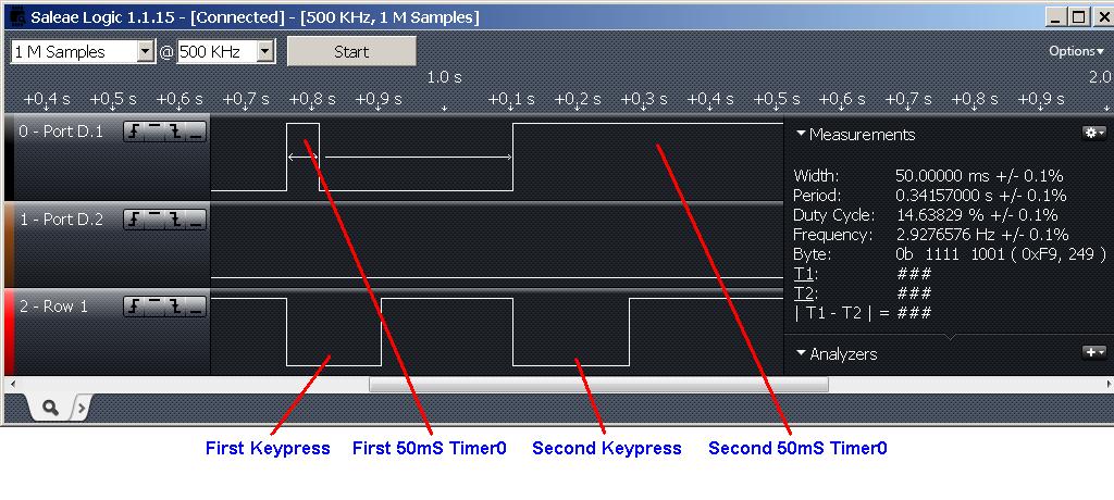

    I can't figure out what other flag I need to reset to use Timer0 a 2nd time.
    Timer0 works for 50mS on the first keypress of the upper left button on the keypad. But it keeps on going on the second keypress.

    Hi Robert,
    I see two problems.
    1) The interrupt service routine ends with a RETURN, it really needs to end with an @ INT_RETURN
    2) In the interrupt "declaration" you have the Clear Flag option set to no so DT-INTS will not clear the flag. Are you saying that you want to do it yourself? In that case you need to do it in the interrupt service routine.
    Jan 2013
    Texas USA
    229
    Default Re: Cannot reset Timer0 properly
    Right on Henrik.
    I came up with the same items. Had just converted the code to work on my HW and was testing.
    These suggested changes seem to work here on my setup Robert.
    TABSoft
    I hate outsmarting myself. I intentionally replaced that RETURN, argh...
    I had also replaced the YES flag. I should have stepped away and taken a break, to take a different look at my code a few minutes later. I somehow thought more was going on and had to handle the flag myself, I obviously didn't. The interrupt won't take off again unless I call Start.

    Eeesh, thanks guys! It works perfectly now.
