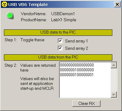

    Mister E's USB routine with DT INTs stripped down to a no-frills template:
    USBDemon1.zip
    1. toggle the checkboxes to send the values to the PIC.
    2. the values are displayed on the LCD.
    3. the PIC automatically returns the values.
    4. the values are displayed in the listbox.
    Original release:
    - removed all the analog logic from Mister E's version.
    - added logic to check the USB connection within the loop.
    April 11 2015:
    - simplified the GUI.
    April 11 2015:
    - shortened file name.
    - cleaned up comments.
    - increased polling speed to 1ms.
    April 12 2015:
    - simplfied code.
    - added DT notes.
    18F4550
    Hitachi 44780 compatible LCD, 2 x 20 char
    PIC Basic Pro v2.60C
    MicroCode Studio Plus v2.2.1.1
    MPASM v5.46
    Win XP
    Lab X1 board
    Last edited by Demon; - 12th April 2015 at 14:23. Reason: Simplified further and added DT notes
