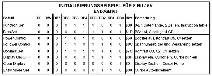

    I just bought a LCD from ELECTRONIC ASSEMBLY http://www.lcd-module.de/deu/pdf/doma/dog-m.pdf. It is a ST7036 (HD44780 compatible) controlled display.
    After I made all required connexions, it doesn't work but I think I need to initialise the display since some settings like "Display ON/OFF" and "Contrast" are set by software (no cabling).
    I've got the initialisation codes in this table (see attachment) but... I don't really know how to use them.
    I declared all DEFINEs and wrote
    LCDOUT $FE, $0F
    to switch the display on? Nothing happens - must be wrong.
    The "$FE" must be wrong. I found also the documentation about the controller that pilots this display here http://www.lcd-module.de/eng/pdf/zubehoer/st7036.pdf.
    It's surely not complicated, nevertheless I'm a little lost...

    I've attached the initialisation codes for this display (unfortunately, it's an 8 bit example - is it important?). Is it possible that the LCDOUT $FE command doesn't fit with this display's controller (ST7036)?
    Roger

    Default Contrast to be set - yes, but how?
    I've got an answer from ELECTRONIC ASSEMBLY (EA). They say this display is fully HD4470 compatible.
    So, until the contrast (all the display in fact) is not initialised properly, nothing will happen on the display.
    I've got this table extracted from the PDF file I inserted in my first post:
    This example is for a 8 bits display. I would prefer to use it with 4 bits but if it is easier to start this way...
    Can somebody tell me what syntax I have to use to modify the contrast settings?
    Is it LCDOUT $FE, $74? I tried this already but nothing happened.
    I don't understand how to use this table. Could somebody explain me please?
    BTW, EA also sent me some assembly examples (see attachments); for those who understand this, it may help, maybe. Unfortunately, I don't know assembler...
    Mister_e, see the picture? Thanks you, again ;-)

    Take a look at http://www.lcd-module.de/eng/pdf/zubehoer/st7036.pdf
    Pages 34-38 tell you exactly what each register contains and what each bit does.
    Page 39 shows 8 bit initialisation
    Page 41 shows 4 bit initialistaion but you dont need to go down to that lave. PBP should take care of that for you.
    Just look for the commands that set the contrast. It look to be "$7x" where x is the setting 0-F for the 16 possible values.
    I would follow Steves advice for leaving a long delay after the first initialistaion command then try something like this

    Until I can try all what you suggest, I would like to understand how you Guys read and interpret the codes in the Initialisation Table I put in my post #19. It looks so obvious to you, unfortunately it is not to me...
    As an example, I would like to know how you come to a LCDOUT $FE, $0C to switch On the display.
    In the table the line sais Display ON/OFF, you see the bits RS(I don't even know what this one is for) and R/W, and then you have for each DB7...0 a value (0 or 1). Finally you've got this $0F value which appears to me as coming from nowhere.
    I admit that the $FE is a standart value for sending datas to the display.
    But, in this example, where comes the $0C from? I'm lost...
    I'm missing this very basic stuff and bothering you with stupid questions so was this discussed in antoher thread already?
    Roger

    $0C - listed in PBASIC PRO MANUAL page 94. $0C = Cursor Off

    Look at the datasheet for the LCD controller, specifically Page 26.
    "Display On/OFF"
    The 8 bits for the register = 00001DCB
    D= display 1=on 0=off
    C=cursor 1=on 0=off
    B=blink cursor 1=on 0=off
    so "00001100"
    Will give Display On Cursor and Blink off which is $0C
    $0C is the command to turn the Cursor OFF but it also turns the dsipay on as well
    $0E will turn the display on with a cursor
