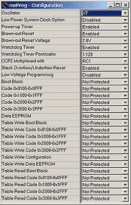

    Well, you can always use the U2 Melabs programmer and the software that comes with it. It is very easy to use.
    http://store.melabs.com/prod/u2/U2.html
    Anonymous
    Default Re: Proper Technique of Setting Config Values
    If you you use the programmer to set the fuses, how do you remember what they were 3 months later?
    George
