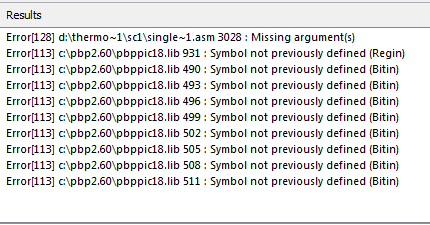

    I'm in the process of putting together a simple version of a project that has been running fine for years. Both use 18F series chips, the original being a an 18F4580, the new being an 18F2520. I've been cutting and pasting variables etc from one project into the new project, and then modifying it as required, however I've now got a symbol not previously defined error, but it's pointing to the PBPPIC18.LIB file rather then the project file, with the (Regin) and (Bitin) being the offending items.
    Any pointers as to how to resolve this ??

    Yes, correct device selected in MCS. The 2520 is the same family as the 4520, just 28 pins, so no port D etc. I've been compiling as I go and up to now it's been fine. Basically I'm trying to make a single channel thermostat from the 4 channel PID code that you, I and the late DT worked on back in 2009, that uses the DTH11 sensor rather than ds18B20's, as the DTH11 includes a humidity sensor as well. I'll try and compile it for an 18F 4580 which was the original PIC used in the 4 channel version which by the way is still running six years later and maintaining the environment in my snakes enclosures without a hitch.

    And attached the results when complied. - I'm stumped - I've tried this using several chips, all 18F series. The original 4 channel code works fine

    Comment all code, then uncomment few lines, and compile. Go block by block until you get error... This could be done in few minutes.
    First comment all code posted on forum, leave just register settings and variable uncommented, compile... Then add all include files, compile, uncomment DT_Int and subrutines for that, try it, etc...
    When you find first line that cause error, post it here...
    Libs are ok, because you can compile original version.

    those missing var's belong to the ds18x20 include , if you aren't using one I guess you provided no defines for one , hence missing arguments .
    If you don't intend to us a ds18x20 why include the include file ?

    a quick look says
    FOR pid_Channel = 0 TO 3 ; Set # of bits in resolution
    GOSUB SelectSensor ; for all sensors
    GIE = 0 ; disable interrupts before 1-wire
    @ DS1820_Resolution 12
    GIE = 1 ; enable interrupts after 1-wire
    NEXT pid_Channel
    but you have
    PID_Channels CON 1
    its not going to fly
    its expecting 3 more sensors

    That is why I said that you uncomment include first. I just did that, and with all variable definition, and code down to label init: compiles OK.
    I need 2min to locate first error...
    DS1820_Select macro Regin, Bitin <macro from include
    DS1820_Select _TempSensor1 <from your main code subroutine SelectSensor
    You didn't put Bitin...
