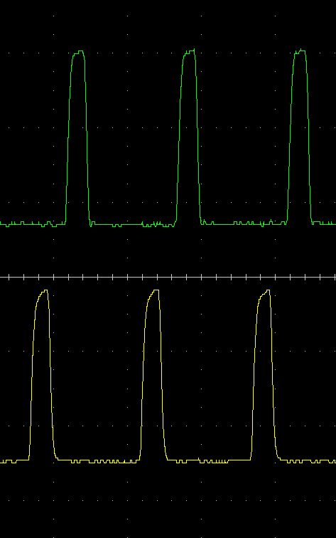

    I'm building an push-pull converter driver using these chips. The code is as follows:
    'PUSH PULL DRIVER
    ANSELA = %00000000  'TURN OFF ANALOG
    TRISA=%00000000     'SET PORTS TO OUTPUT
    OSCCON = %11111111  'SET INTOSC TO 32MHZ
    tavuka:
    PORTA.2=1
    PORTA.2=0
    PORTA.4=1
    PORTA.4=0
    GOTO TAVUKA
    The problem is, that measured port OFF times are longer than ON times, as you can see on attached scope:
    Any ideas how to fix this?

    Tried with LATA - no difference. ON time is about 220ns, OFF time is about 760ns. In terms of PWM, this means 50% duty, so another 50% is simply wasted.

    As I see, this is caused by loop, which returns program to beginning.
    For example, I've tried to lengthen code by repeating commands 4 times without using loop, and 4 pulses are correct.

    Here is your code explained:
    tavuka:
    PORTA.2=1'<turn on PORTA.2, need 4 osc clock to do that, then next instruction
    PORTA.2=0'<turn off PORTA.2 need 4 osc clock to do that, then next instruction
    PORTA.4=1'<4 clock to do this, but it doesn't do anything with PORTA.2
    PORTA.4=0'<4 clock to do this, but it doesn't do anything with PORTA.2
    GOTO TAVUKA '<4 or 8 clocks(can remember) to do this, but it doesn't do anything with PORTA.2
    So when you count all clock, you have 4 osc clock long high state on PORTA,2, and 16 clock low state on PORTA.2.
    Similar situation is with PORTA.4...
    Program execute exactly what you are tell, Not what you want...

    Even if code is like this:
    HEAD:
    PORTA.2=1
    PORTA.2=0
    GOTO HEAD
    the "goto" occupies much more time. Is there a way to shorten it?
    3,615
    Default Re: 12F683, 12LF1840 - Port ON/OFF speeds are different!
    No, there's not way to shorten the execution time (in instruction cycles that is) of a GOTO. What you can do is to "lengthen" the time of the other instructions.

    I don't want to "lengthen" time, because it significantly lowers the frequency, from about 1mhz to 200khz, which is bad. I've found a partial workaround - I've inserted
    PORTA.2=1
    PORTA.2=0
    PORTA.4=1
    PORTA.4=0
    16 times, so now having about 90% duty cycle, which is ok.
    But, is there a way to fix this otherwise?

    Would it be easier to do this with PWM module? With 32MHz you can reach 4MHz output frequency and accurate duty cycle.
    I think these PIC's have just one PWM module. If that is not enough, then select other which have more PWM outputs.
    At least, trials can be run with your current PIC's.
    Feb 2013
    1,150
    Well, I asked that before...
    I use 2 channels as you can see from scope, and I need to have adjustable dead time between outputs, to avoid short circuit. Is it possible to synchronise 2 PWM generators in that way?

    I think that you will not be able to do phase shift (delay) between 2 PWM outputs in same PIC. With 2 PIC's this might bee possible.
    If your system is so time critical that GOTO-command will generate problems then how you will monitor and adjust outputs?
    Therefore I don't see any other options than using HW modules (PWM) and PIC code just monitor and control HW module(s).

    PIC18F14K22 have everything what you need:
    Enhanced Capture/Compare/PWM (ECCP)
    module:
    - One, two or four PWM outputs
    - Selectable polarity
    - Programmable dead time
    - Auto-shutdown and Auto-restart
    - PWM output steering control
    And all that controlled from comparators outputs.
    If comparator output is low or high(selectable) pwm outpu can go to some state, high or low.
    You can turn on/off hysteresis on comparators, etc...
    Just read this 404 pages and you will know everything you need

    Another guess is that PIC18F14K22 won't be available in SOIC-8....
    3,615
    Take a look at the 12F1501, it might do what you want and comes in 8pin package.
    the 1840 in ECCP half bridge mode looks to be fine too, no ???
