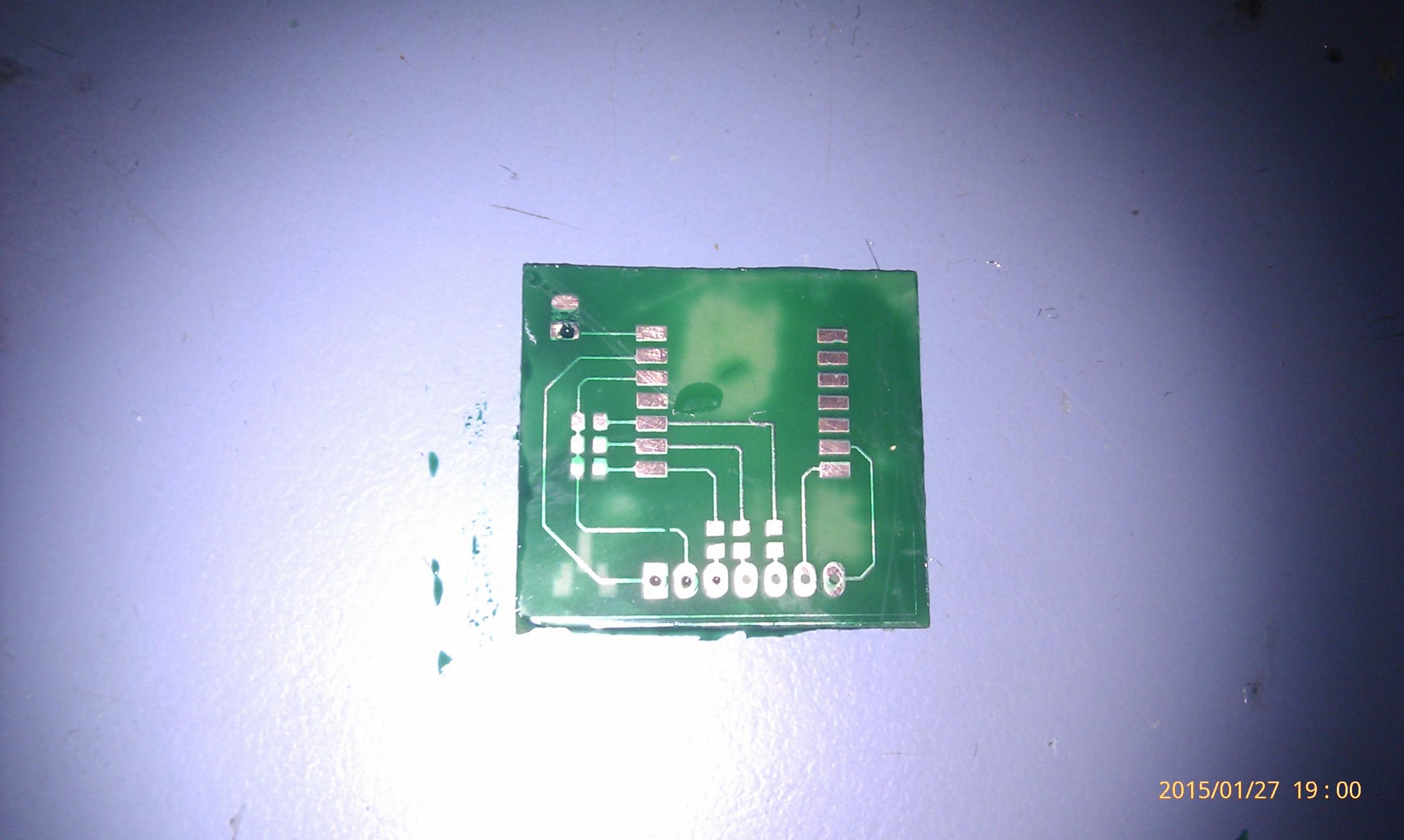

    success
    used a ziplok sandwich bag (its a rf12b/69cw breakout board)
    the mask is for a slightly different layout , its only an experiment

    Nice Job!
    If you perfect the process, post your methods. It will be better than translating Chinglish.
