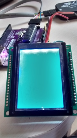

    I think I missed something : I the picture bellow, showiung the OLED display, I have :
    serout2 OLED, OLED_BAUDRATE, ["DR2299", 0] which makes no sense for me. I have to admit that I did not understand the BBBB notation.
    Could you, please, give another example ?

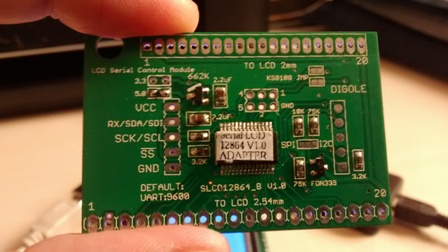

    Changing the display to a KS0108 with the backpack, I used the same code and connected the VCC, GND and the RX/SDA, SDI pin but, it did not work. The packpack is being used like in the pictures, without any additional config. I was just soldered on the KS0108.
    Thank you fo the help !
    Sérgio

    On the page for the back pack (http://www.digole.com/index.php?productID=535)
    jumper 7: short both for KS0108.
    The serial data is sent to the pin "RX/SDA".
    HTH
