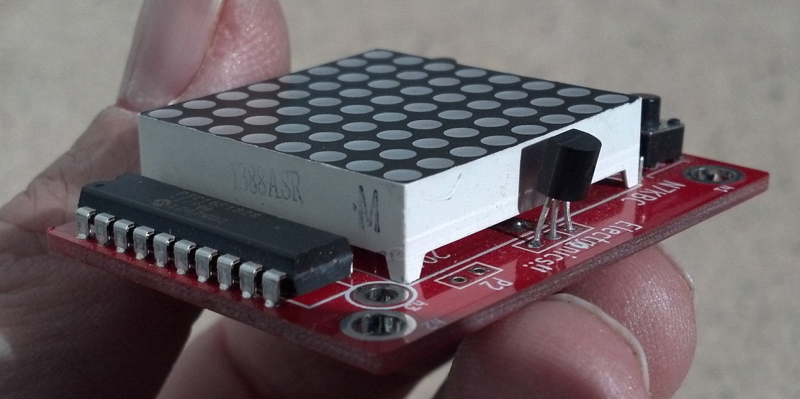

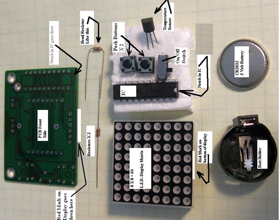

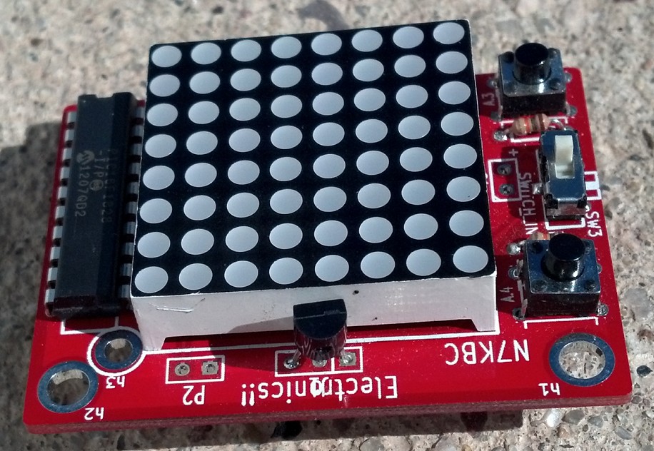

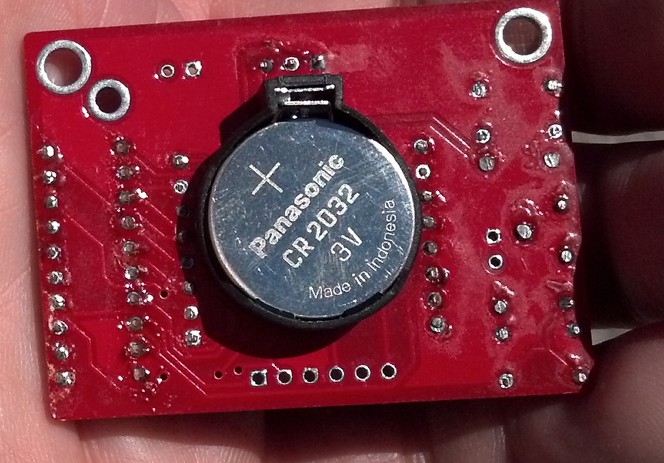

    I realize that this little routine might introduce a few milliseconds error once every year or so to reset the counter to <365 Days.
    But, bear in mind that my project is a BOY SCOUT "Electronics" merit badge kit. The kit is powered by a CR2032 coin cell. It fills the final requirement to solder up a project.
    Over the past 3-4 years we have built over 400 of these little kits.
    I am just toying with the idea of allowing the kit to keep time.
    Currently here is what the kit does...
    * displays the Boy Scout Law
    * display current temperature
    * track and remember Low and High temperature (if left on,
    goes to sleep to save batt and wakes up every 60 sec to check temp)
    * play a little race car game
    * display several smiley faces and other icons
    I designed this kit to be useful and teach microcontrollers
    (which is what most hobby "electronics" today is centered around)
    Since I have to re-order more PC boards I thought I would add an RTC to the design.
    (I would pre solder the RTC and crystal as it is surface mount)
    the Scouts do amazingly well for such small soldering. I have an experienced solder coach sit across from them as they build the kit in about 30 min.
    What do you think...

    PS
    you can see the DS18b20 temp sensor at the top above the 8x8 LED matrix
    the two large holes at the top corners are for a cord lanyard to be attached and the Scouts can wear it around their neck.
    the two push buttons allow for different functions and for the race car game to be played when turned sideways.
    The CR2032 battery lasts for a LONG! time... at least a couple of years of random usage
    Here is a crude hand drawn schematic.
    All the pins are in use on the 20 pin PIC
    You can see that the DS18b20 is tied to one of the pushbuttons
    I plan to tie the RTC to the other push button
    Therefore either of the OneWire devices can only be read when the button is NOT depressed.
    (I account for that limitataion in code)
    No, there are no current limiting resistors used because of the internal impedance of the CR2032 batt
    and I pulse the rows and columns of the LED matrix to limit current (haven't had a failure yet)
    the Kit has been a great success and hopefully inspired some new electronics enthusiasts!
    The DS2417 RTC would be powered directly from the battery and not powered down when the PIC is off.
    I will tie the RTC to the other button input (this way I can ignore the One Wire address requirement as each input will only talk to one OneWire device)

    Dwight,
    Congratulations!
    What a great project and an excellent reason for putting it together.
    Providing real meaningful time to the Scouts.
    You could have selected an off the shelf Time and Temp eKit and directed your Troop members to it.
    But what real meaning would that have had?
    Instead you created your own eKit that has direct and long-lasting meaning for a Scout.
    Besides providing an electronics project for their merit badge and mentoring/overseeing their attainment of the badge.
    You personalized the project.
    Displaying the Boy Scout Law. Adding a game, having it display Smiley faces.
    Creating a way to wear the project.
    It is truly inspiring to see an individual not only donate charitable time to an organization,
    but to also see them embody the primary tenets of the organization itself while doing so.
    Outstanding!
