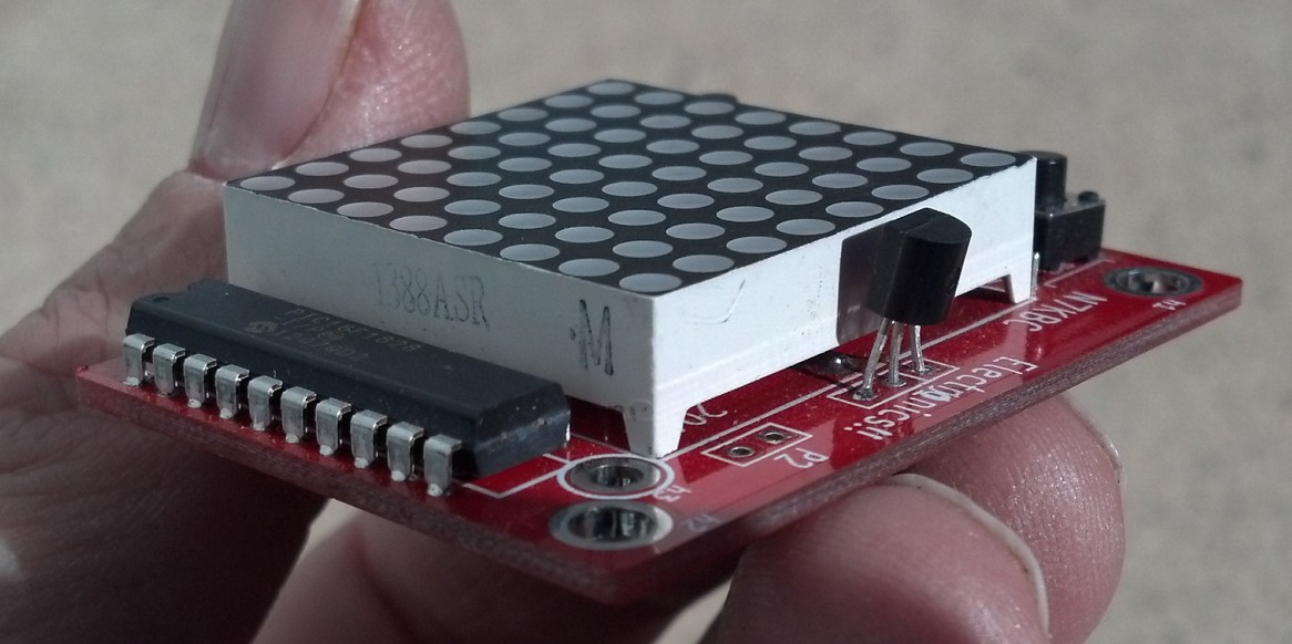

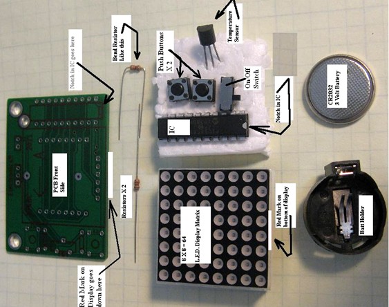

    I designed this kit to be useful and teach microcontrollers
    (which is what most hobby "electronics" today is centered around)
    Since I have to re-order more PC boards I thought I would add an RTC to the design.
    (I would pre solder the RTC and crystal as it is surface mount)
    the Scouts do amazingly well for such small soldering. I have an experienced solder coach sit across from them as they build the kit in about 30 min.
    What do you think...

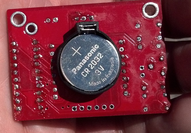

    PS
    you can see the DS18b20 temp sensor at the top above the 8x8 LED matrix
    the two large holes at the top corners are for a cord lanyard to be attached and the Scouts can wear it around their neck.
    the two push buttons allow for different functions and for the race car game to be played when turned sideways.
    The CR2032 battery lasts for a LONG! time... at least a couple of years of random usage
