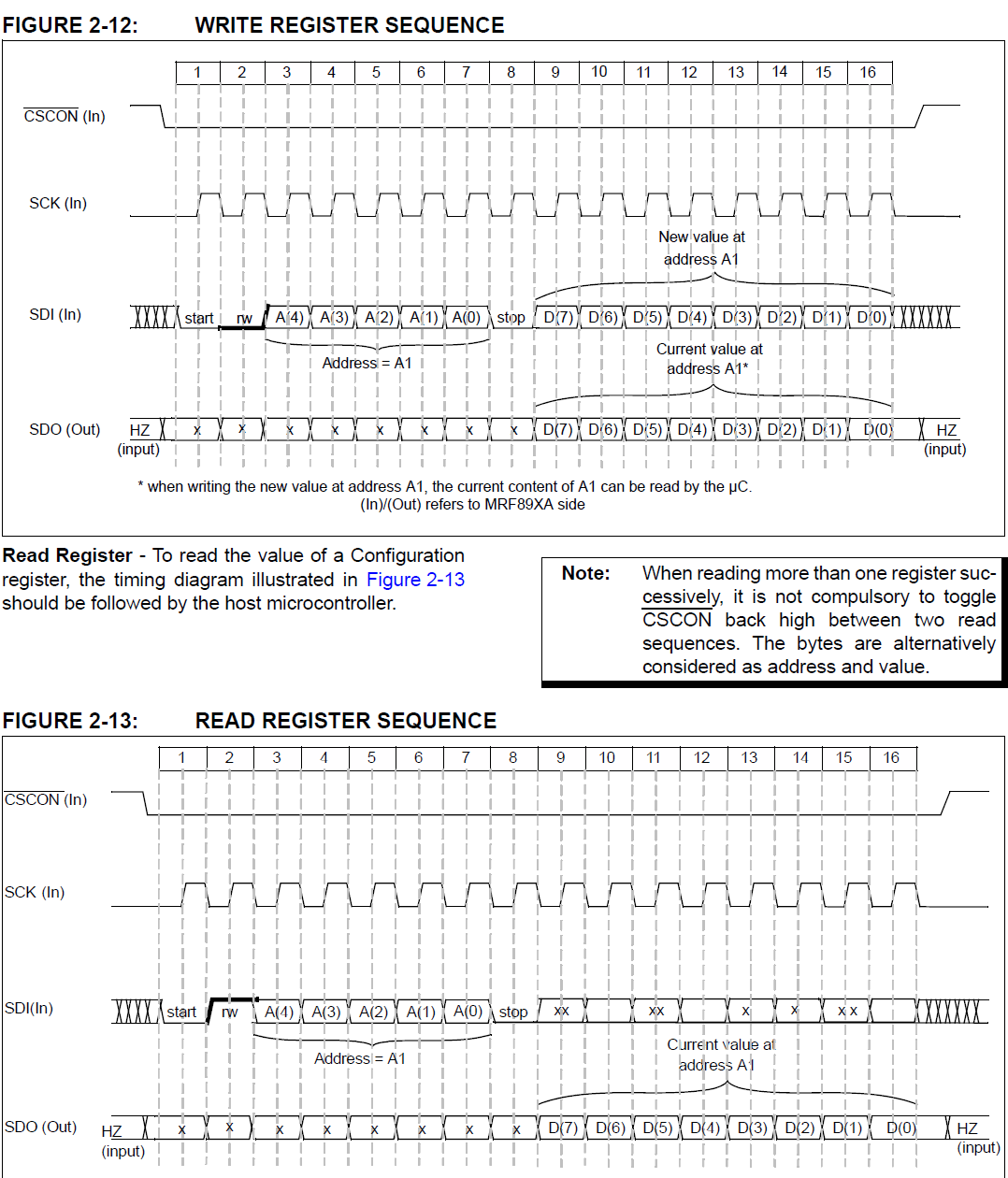

    Good Afternoon All-
    I have been trying to get the MRF89XAM9A module to work with a PIC18F66J11 and I can't seem to get the read function to work (SPI) so I can see if I am setting up the module correctly.
    I am hopefully writing to the module then reading back from it to verify the register - but it doesn't work......
    I have looked on this forum for sometime but no one seems to have either tried or shared how to set up the regs and how to just very simply to communicate to/from it.
    Its just a simple many transmitter to one receiver idea, only a payload of 3 bytes!
    If anyone HAS gotten this to work, I would appreciate any guidance ......
    Code below for all to see.....
    -Steve

    Also I think you need to release the CSCON line (MFRConfigSel=1) after you write the initialization values and before you try to read them back.
    From the DS.
    The new value of the register is effective from the rising edge of CSCON.
    When writing more than one register successively, it is not compulsory to toggle CSCON back high between two write sequences. The bytes are alternatively considered as address and value. In this instance, all new values will become effective on rising edge of CSCON.
    TABSoft
    Jan 2013
    Texas USA
    229
    Default Re: MRF90XAM9A interfacing help
    I could be completely wrong here but it looks like it uses 5 bit addresses for the config registers.
    Looking through the MRF89XA Datasheet further in section 2.11.1 (SPI CONFIG), figures 2-12 (Write Register Sequence) and 2-13 (Read Register Sequence) on page 24, it looks like the address bytes only use 5 bits for the address and 2 bits for a preamble and 1 bit for a postamble for a total of 8 bits.
    The Preamble bits look to be the following:
    Bit 1: is a start bit and it is a 0
    bit 2: is a R/W bit. 0=Write, 1=Read
    The Postamble Stop Bit is a 0
    So, if I interpret the timing diagrams correctly if you are trying to Write to register 0x00 your address byte will be 0x00. But, to read Register 0x00 your address byte will be 0x40 (%01000000) noting that the DS states all data is received and sent MSB first.
    Bit 7: Start bit = 0
    Bit 6: R/W bit = 1
    Bit 5: Address bit 4 = 0
    Bit 4: Address bit 3 = 0
    Bit 3: Address bit 2 = 0
    Bit 2: Address bit 1 = 0
    Bit 1: Address bit 0 = 0
    Bit 0: Stop bit = 0
    Carrying on further, if you want to Write to and Read from register 0x09, I think these are the address byte values to use.
    Register 0x09
    Write: 0x12 (%00010010)
    Bit 6: R/W bit = 0
    Bit 4: Address bit 3 = 1
    Bit 1: Address bit 0 = 1
    Bit 0: Stop bit = 0
    Read:0x52 (%01010010)
    Bit 6: R/W bit = 1
    Bit 0: Stop bit = 0
    If these assumptions are correct you can just AND your address with with the appropriate mask for the preamble and postamble bits for Write or Read.
    Hope I am not taking you down a rabbit hole....

    I took a look at the Microchip AN1340 appnote "MRF89XA Radio Utility Driver Program".
    Link: http://www.microchip.com/wwwAppNotes...pnote=en549380
    I downloaded the Source Code from that link and reviewed the interface Write/Read routines to the MRF89Xa.
    They do indeed account for the Preamble and Postamble I mentioned earlier.
    Notice what they do with address during the RegisterSet and RegisterRead functions before they call the SPIPut function.

    For a Write (RegisterSet) they leftshift the address 1 position.
    For a Read (RegisterRead) they leftshift the address 1 position and then OR that with 0x40 (sets bit6)

    TABSoft, you are CORRECT, I didn't notice the 3 'special' bits. Going to steal some time and see about this today........
    More later,

    I did find the double 'OR' but it didn't seem to help.
    I also remarked the chip selects and deselects - no help either.
    Thanks though for trying!
    The code in the next post is where I am now, but, its confusing when you can't read the register to know if its set, then, transmission to a ZENA
    sniffer I found on another board said that it is useless if you are not using MiWi......
    Ugh!

    I think, with no certainty, that reading the part has to be done using hardware SPI in full-duplex mode. I don't see any way to SHIFTIN to send the address, and then SHIFTOUT to get the data accurately.
    I used hardware SPI (simplex) on a different project and it worked great, but I wasn't trying to write and read simultaneously.
    Has anyone had any luck using hardware SPI in a full-duplex project?
    If so, any help would be appreciated - maybe that is what I need to do?

    I do have a question, in the timing diagram below:
    Name:  MRF90XAM9A SPI timing.png
    It looks to me as if there is a dummy byte before the real data, am I confusing myself?

    I guess I don't see what you're referring to "dummy byte before the real data".
    Where specifically are you speaking of?

    And test code is:
    'MRF initialization here
    debug "@ MRF init", 10
                MRFConfigSel=0                                                      'Select the chip
    'Going to try using shiftout before using hardware SPI
                for i=0 to 31                                                       'Sets up the index var for data
                    MRFaddr=(i << 1)                                                'Shifts address 1 bit to left, automatically gets start,write, and stop bits
                    SHIFTOUT SDO, SCLK, 1,[MRFaddr,RF_Init_Values(i)]               'send data to register
    debug "Addr=",bin8 MRFaddr,"  Value=",hex2 RF_Init_Values[i],13
                next i
                MRFConfigSel=1                                                      'Deselect the chip
    'Try to read back some registers as a test to see if they were written correctly
                for i = 0 to 7                                                      'Sets up address to read
                    MRFaddr=((i << 1) | $40)                                       'Shifts left 1 bit, sets $40 bit, automatically gets start, READ, and stop bits
                    SHIFTOUT SDO, SCLK, 1,[MRFaddr]                                'Address to read
                    SHIFTIN SDI, SCLK, 0,[MRFSPIdata]                              'Get data from reg
                    debug "MRF Config data: i=", dec1 i, "   Register ", bin8 MRFaddr, "   Data=", hex2 MRFSPIdata,13
                next i
    'Try sending something
    debug "Try sending 3 bytes",13
    XMIT_EN:   i=0                                                                 'Register of interest
               MRFaddr=(i<<1)                                                      'Gets register address format
               SHIFTOUT SDO, SCLK, 1,[MRFaddr,$88]                                 'send data, TRANSMIT, 915-928, Vtune by tank caps, Enable R1 P1 S1
    XMIT:      MRFDataSel=0
               SHIFTOUT SDO, SCLK, 1,[$A1]
               MRFDataSel=1
               MRFDataSel=0
               SHIFTOUT SDO, SCLK, 1,[$B1]
               MRFDataSel=1
               MRFDataSel=0
               SHIFTOUT SDO, SCLK, 1,[$C1]
               MRFDataSel=1
    RCV:       i=0                                                                 'Register of interest
               SHIFTOUT SDO, SCLK, 1,[MRFaddr,$68]                                 'send data, RECEIVE, 915-928, Vtune by tank caps, Enable R1 P1 S1
    Wait4Pkt:  If MRFIrq0=1 and MRFIrq1=1 then
                  MRFDataSel=0                                                     'Select chip cuz we have a packet ready and CRC is good
                  SHIFTIN SDI, SCLK, 0,[data3,data2,data1]                              'Get data from reg
    debug "MRF payload:  Data3=",hex2 data3,"   Data2=",hex2 data2,"   Data1=",hex2 data1,13
               goto Wait4Pkt
    But after init and the confirming of the 1st few registers as before - it just sits there like a plum.
    I seem to have the config registers working, but now the FIFO seems to be playing hard.
    My interrupts aren't being set either due to not transmitting or receiving correctly.
    My payload is only 3 bytes, and the smallest the FIFO can be is 16 bytes.
    Not much for me to scope on this...... MC's DS is not too clear but you honed in on a failure I had, do you see anything wrong?
    This is my 1st RF project so I may have the registers all screwed up in order to work.... not too much out there as a guide.
    Regards.

    Sorry, I had posted an older piece of code. Newest code below:
                next i
                next i
    XMIT:      MRFDataSel=0
               MRFDataSel=1
               MRFDataSel=0
               MRFDataSel=1
               MRFDataSel=0
               MRFDataSel=1
                  SHIFTIN SDI, SCLK, 0,[data3]                                     'Get data from reg
                  MRFDataSel=1                                                     'De-Select chip
                  SHIFTIN SDI, SCLK, 0,[data2]                                     'Get data from reg
                  SHIFTIN SDI, SCLK, 0,[data1]                                     'Get data from reg
               goto Wait4Pkt

            MRFregister     var byte                                                'MRF register we want to read/write
            MRFaddr         var byte                                                'MRF address which is 5 bytes
            I2CData         var byte                                                'Data byte to/from I2C buffer
            junk            var byte                                                'Hold dummy data from MRF
            data1           var byte                                                '1st byte from MRF payload
            data2           var byte                                                '2nd byte from MRF payload
            data3           var byte                                                '3rd byte from MRF payload
    'Constants here
    '     RF_Init_Values[0] = $28                                                   'Standby mode, 915-928 MHz, VTune by inductors, ENABLE R1/P1/S1
         RF_Init_Values[0] = $68                                                   'RECEIVE mode, 915-928 MHz, VTune by inductors, ENABLE R1/P1/S1
         RF_Init_Values[1] = $8C                                                   'FSK, max IF gain, Packet Mode
         RF_Init_Values[2] = $01                                                   '200KHz Freq Dev
         RF_Init_Values[3] = $63                                                   '2KBps
         RF_Init_Values[4] = $0C                                                   'for OOK mode, not apliable
         RF_Init_Values[5] = $03                                                   '16Bytes FIFO, 3 Bytes threshold FIFO transmit interrupt
         RF_Init_Values[6] = $77                                                   '915MHz R1 Reg
         RF_Init_Values[7] = $64                                                   '915MHz P1 Reg
         RF_Init_Values[8] = $32                                                   '915MHz S1 Reg
         RF_Init_Values[9] = $74                                                   '920MHz R2 Reg
         RF_Init_Values[10] = $62                                                  '920MHz P2 Reg
         RF_Init_Values[11] = $32                                                  '920MHz S2 Reg
         RF_Init_Values[12] = $38                                                  'config mode for OOK, not apliable
         RF_Init_Values[13] = $0D                                                  'RCV:IRQ0=payload ready + IRQ1=CRC OK
                                                                                   'TX: mostly normal
         RF_Init_Values[14] = $39                                                  '00111001
         RF_Init_Values[15] = $00                                                  '
         RF_Init_Values[16] = $A3                                                  'default filters config
         RF_Init_Values[17] = $38                                                  'default filters config
         RF_Init_Values[18] = $30                                                  'sync word ON, 24bits, 0 errors tolerance
         RF_Init_Values[19] = $00                                                  'reserved reg
         RF_Init_Values[20] = $00                                                  'RSII status read register, 0.5dB / bit
         RF_Init_Values[21] = $00                                                  'OOK config reg
         RF_Init_Values[22] = $53                                                  '"S" 1st byte of sync word
         RF_Init_Values[23] = $43                                                  '"C" 2nd byte of sync word
         RF_Init_Values[24] = $53                                                  '"S" 3rd byte of sync word  - my initials!
         RF_Init_Values[25] = $00                                                  '
         RF_Init_Values[26] = $70                                                  'utoff fcy = 200KHz, output power = 13dBm 0b000
         RF_Init_Values[27] = $BC                                                  'clk out by default 427KHz
         RF_Init_Values[28] = $02                                                  '3 bytes payload
         RF_Init_Values[29] = $01                                                  'initial MAC ADDRESS, only for test
         RF_Init_Values[30] = $5E                                                  'Fix Packet Lenght, 3 bytes preamble, whitening ON, CRC ON, Node ADDR|0x00|0xFF filtering
         RF_Init_Values[31] = $00                                                  'FIFO autocreal enable if CRC fails, Write to FIFO in stby mode     for (i = 0; i < 32; i++)
    4. MRF initialization
                next i
                next i
    5. Then I try to send something via MRF
    XMIT:      MRFDataSel=0
               MRFDataSel=1
               MRFDataSel=0
               MRFDataSel=1
               MRFDataSel=0
               MRFDataSel=1
    6. Then MRF switches to receive to try to receive the 3 bytes (from the other unit of course).
               goto Wait4Pkt
    My method is this:
    I turn on both units and watch for debug information.
    At this time both units should be in receive mode - not very helpful.
    So then I reset one of the units which will make it go through everything again including transmit the 3 bytes.
    Nothing comes up on the debug window.
    No interrupt gets set
    I do see IRQ1 (I think - from memory) go high briefly on the transmitting unit which should be transmission done.
    I think its in my NOT understanding the transmission/reception registers - I'm more of a digi-head with some analog.
    The DS is not too helpful and the Microchip boards and forum are also not very helpful.
    Most of the work seems to be using the 2.4 GHz unit but I wanted to use the sub-ghz unit due to my desire to go throughout the house.
    You can PM instead of taking up forum space, I will post my final code using hardware SPI and working code for the MRF - as I am certain there HAS to be others struggling!
    Regards.

    RegisterSet:
    'Inputs: bReg_Address, bReg_Value
        MRFaddr=(bReg_Address<<1)                                           'Gets register address format
        SHIFTOUT SDO, SCLK, 1,[MRFaddr,bReg_Value]                          'Set the register
    RegisterRead:
    'Outputs: bReg_Value
        MRFaddr = ((bReg_Address << 1) | $40)               'Shifts left 1 bit, sets $40 bit, automatically gets start, READ, and stop bits
        MRFConfigSel = 0                                    'Select the chip
        SHIFTIN SDI, SCLK, 0,[bReg_Value]                   'Get data from reg
        MRFConfigSel = 1                                    'DeSelect the chip
    RegisterRead:'Inputs: bReg_Address - Outputs: bReg_Value

    Reading the MRF89XAM9A datasheet on page 7 "1.3.5 VCO TANK TRIM VALUE", it says you need to set VCOT<1:0> = ‘01’.
    From Datasheet:
    The VCO Trim bits (VCOT<1:0>) in the
    GCONREG<2:1> should be set for VCOT<1:0> = ‘01’
    for the inductor values of the module.
    That would change MC's value of Register 00 from $2E to $2A, and your value of Register 00 from $28 to $2A.
    That might explain why the PLL won't lock.

    I changed the Register 00 to $2A and it still reports PLL bit as '0'.
    BUT, on page 30 of the DS it shows $00 for VTune to be determined by the inductors - not $01 ???
    Forget it, I was still reading the 140 page DS not the 36 page one for the module.
