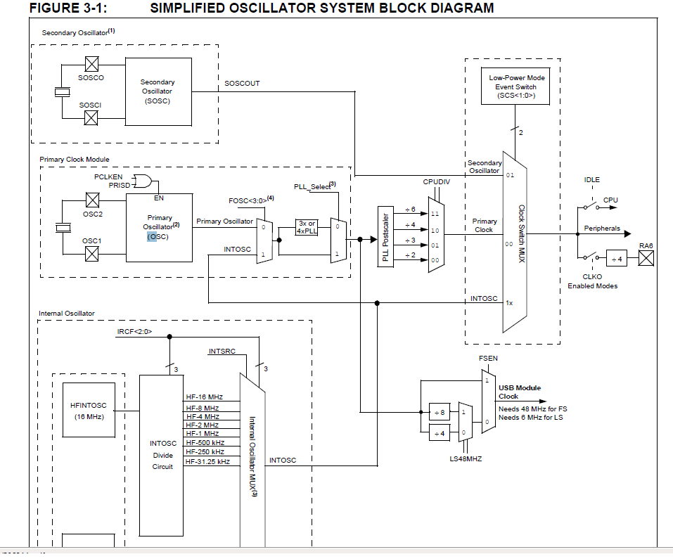

    you have not really provided any clue at all to what you problem is
    but looking at the data sheet osc description I doubt that
    DEFINE OSC 48
    is correct
    they way I see it it needs to be
    DEFINE OSC 24
    the x3 pll is followed by a /2 stage and the 48mhz only goes to the usb module

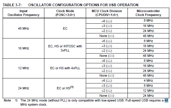

    According to this chart, using the internal OSC with 3x PLL and no clock divider, it should be at 48MHz if I am understanding it correctly.
    CONFIG FOSC=INTOSCIO
    CONFIG PLLSEL=PLL3X
    CONFIG CPUDIV=NOCLKDIV

    ok looks like 48mhz clock is more likely to be correct , the table makes no mention of the /4 option as depicted in the osc diagram fig 3.1 ,and a 0 divide option seems more probable
