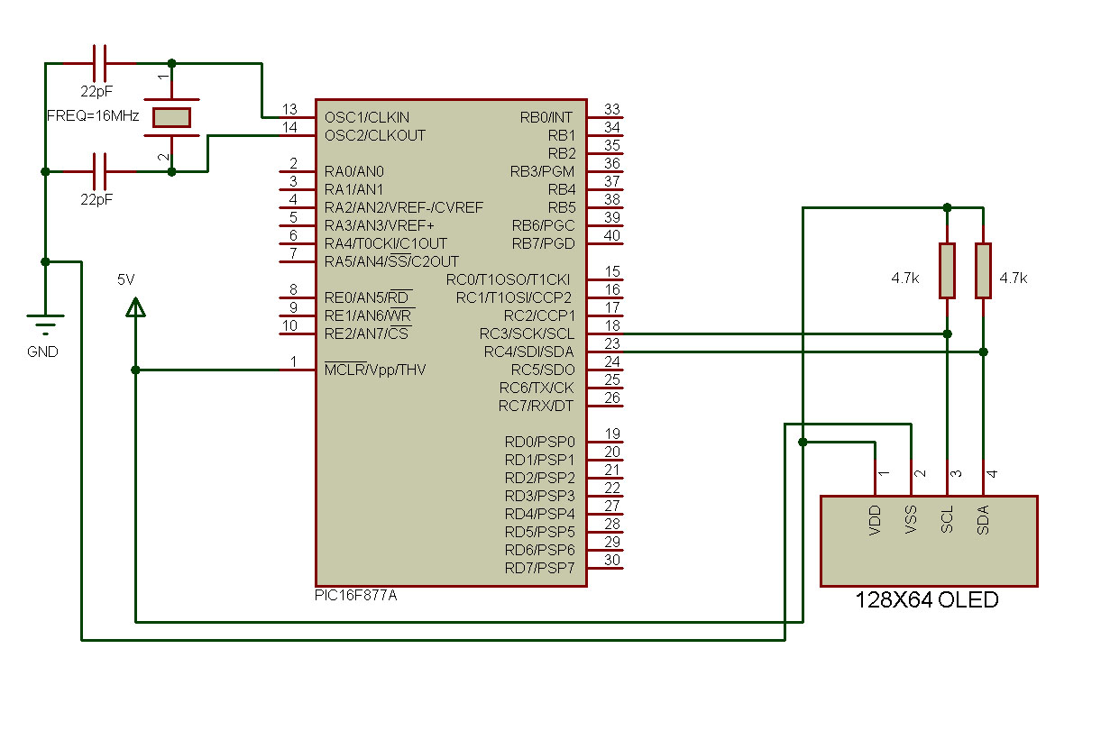

    To display the data you send through I2C or SPI, I have a problem and hope you can help me.
    Default Re: OLED 128X96 cheap china lcd
    Quote Originally Posted by Denner View Post
    I have altered Joe's original code to use I2C for comms. I used PIC16F88 for the below code. I used a monochrome display running ssd1306 driver/controller.

    I have a 128x64 0.94" mono oled with ssd1306, I copied and tried CircuitDomain's modified code since he's using same device but I couldn't see any graphics on screen :\
    I'm using 16f877a and made necessary changes on code. I'm able to drive the screen with arduino uno but I want to use it with PIC.
    So, can anyone see what is the problem on codes? Or any suggestion ?

    And here is my exact circuit connection
    Attachment 7849
    Hi everyone,
    After looking at your schematic, the only problem I see is if the pull-up resistors are tied to +5v, then you would probably be damaging the inputs to the display. They are at 3-3.3v levels. I killed one by not paying attention to the voltages requirements of the device.
    I changed the code to suit my F887 and it still doesn't work.
    Hope this helps.
