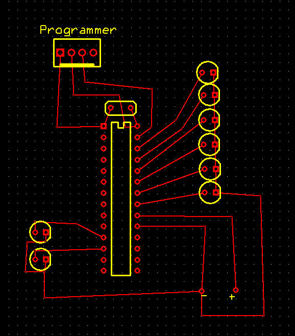

    a little scheme ( the real one ... ) would be useful now ... especially for the RESET pin ...

    I did a schematic in PCB express and this is exactly how its connected. I just want some LED to light up.
    This one works perfect then I use GCB and PICPgm to program the chip. I use PICPgm to program it now too.Name:  scheme.jpg

    Default Re: PIC16F886 not running.
    default pbp3 fuse config
    __config _CONFIG1, _INTRC_OSC_NOCLKOUT & _WDT_ON & _MCLRE_ON & _LVP_OFF & _CP_OFF
    yet you have no pull up resistor on mclre_pin (1)
    no vss on pin 8
    no current limiting resistors for leds ( will cause rmw issues)
    what is that unspecified thing between portb7 and mclre ?

    LilleJung,
    PLEASE ....
    open your Datasheet and begin by the supply circuit, then the Reset (MCLR) wiring ... one more trail from those, and your '886 is fried ...

    The config statement helped a bit, now the LEDs on PORTC blinks. But nothing on PORTB.
    I set MCLRE_OFF instead of MCLRE_ON and now I even can have the programmer connected and the chip works.
    I have a pull-up resistor on MCLR also, but it works without it too. And current limiting resistors on the LEDs.
    Now all I want is to get PORB to blink, then im up and running. I really want to migrate to PBP. GCB was great, but a little too many bugs for me.
    PORTB.6 and PROB.7 is always connected to the programmer circuit (a homemade AN589 programmer).

    Your schematic also is not showing a connection between the programmer and negative power (Vss)
    I imagine that should be the spare terminal on the program connector?
    Which programmer are you using?
