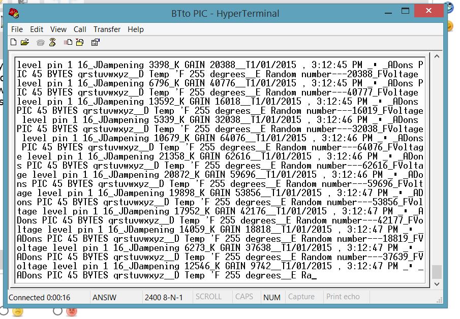

    Default Re: usart-bluetooth problem
    to test bt link, program a pic to serout some data say "1,2,3,4 a,b,c,d" every second or so to the bt module. the baud from pic to module should match but the bt to pc link makes its own rate. I'm sure you found the com port created by the bt device through the SPP - serial port profile mode seen in bt settings on win8. on my device bt set up 2 com ports of which one works the link. with that you can try/check for the correct T and R connections at pic end.
    I put hyperterm on my win8 just copy pasted 2 files
Size:  54.8 KBName:  Capture.JPG

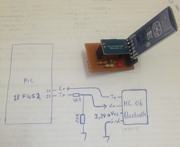

    Also, as previously suggested, why don't you post a drawing of your circuit and connections. That will help others to understand what you have and potentially be able to offer advice.

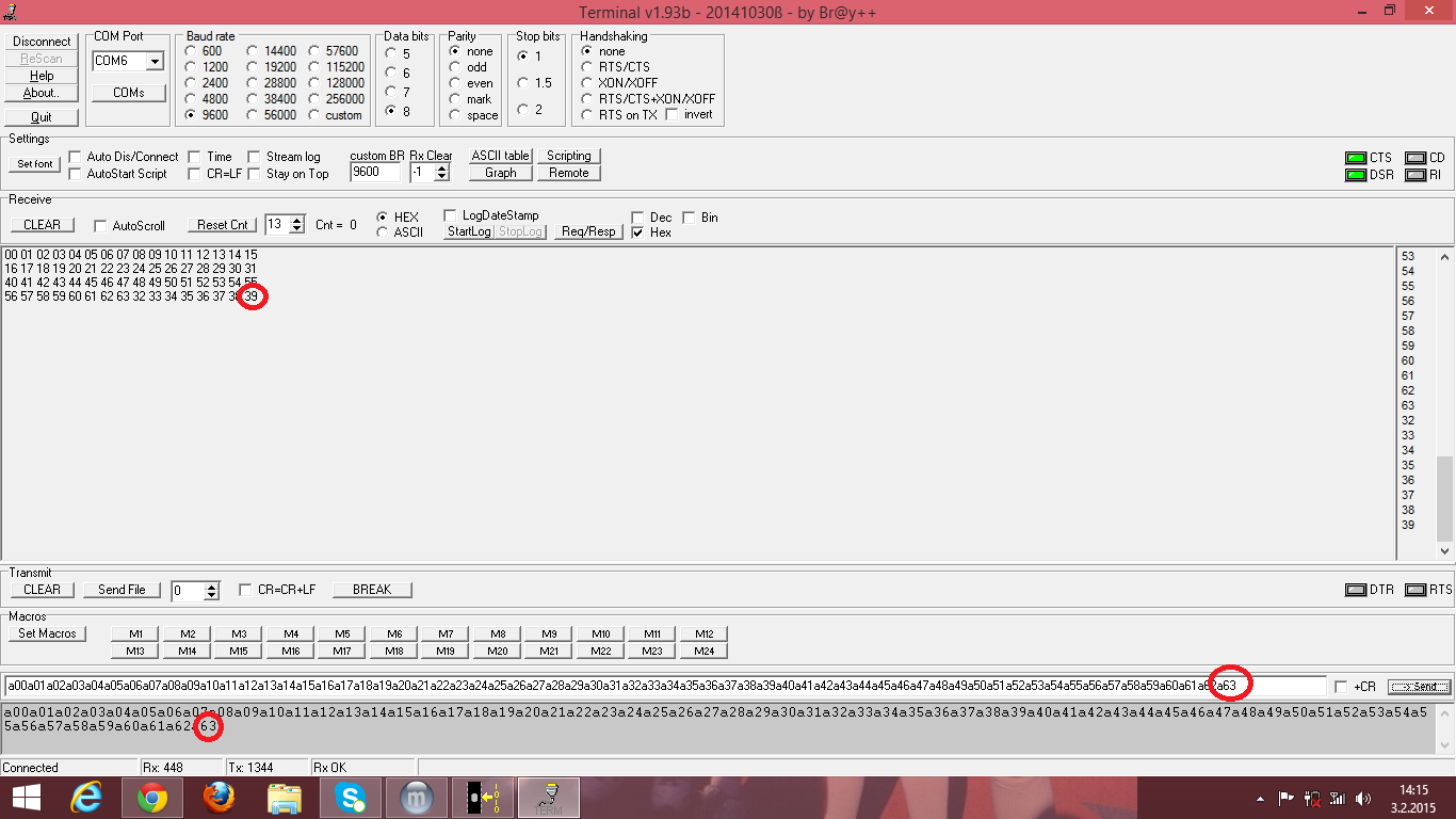

    i updated my codes as shown below. lcd always displays "timed out!" even if i send data from terminal. i dont know the reason of this but device is deaf...
    how can it be that the device (pic, i mean) can send data to pc through bluetooth but can not receive data from pc? is it possible? it pairs, sends but can not receive... it looks weird. what can be possible errors about this issue? here is my latest codes and drawings:
    PS: i downloaded Bray's terminal.exe and im using it... as charlie said before, "bray's" is much more better than pussy, sorry putty
    Reading the 18F452 Datasheet, RC6 (USART TX) and RC7 (USART RX) are Schmitt Trigger buffered inputs. Also reading the Datasheet (pg. 265 DC Characteristics) shows the following for ST type I/O pins:
    Input Logic Low: Min = VSS, Max = .2 VDD
    Input Logic High: Min = .8 VDD, Max = VDD
    If you are running your PIC at 5 Vdc then that would translate to:
    Input Logic Low: Min = 0V, Max = 1V
    Input Logic High: Min = 4V, Max 5V
    The HC06 running at 3.3V will not output voltage levels that high so the PIC will not recognize a High Logic Level.
    You'll need to run the PIC at 3.3V, if you can, or you'll have to level shift the I/O between the two devices.
    TABSoft

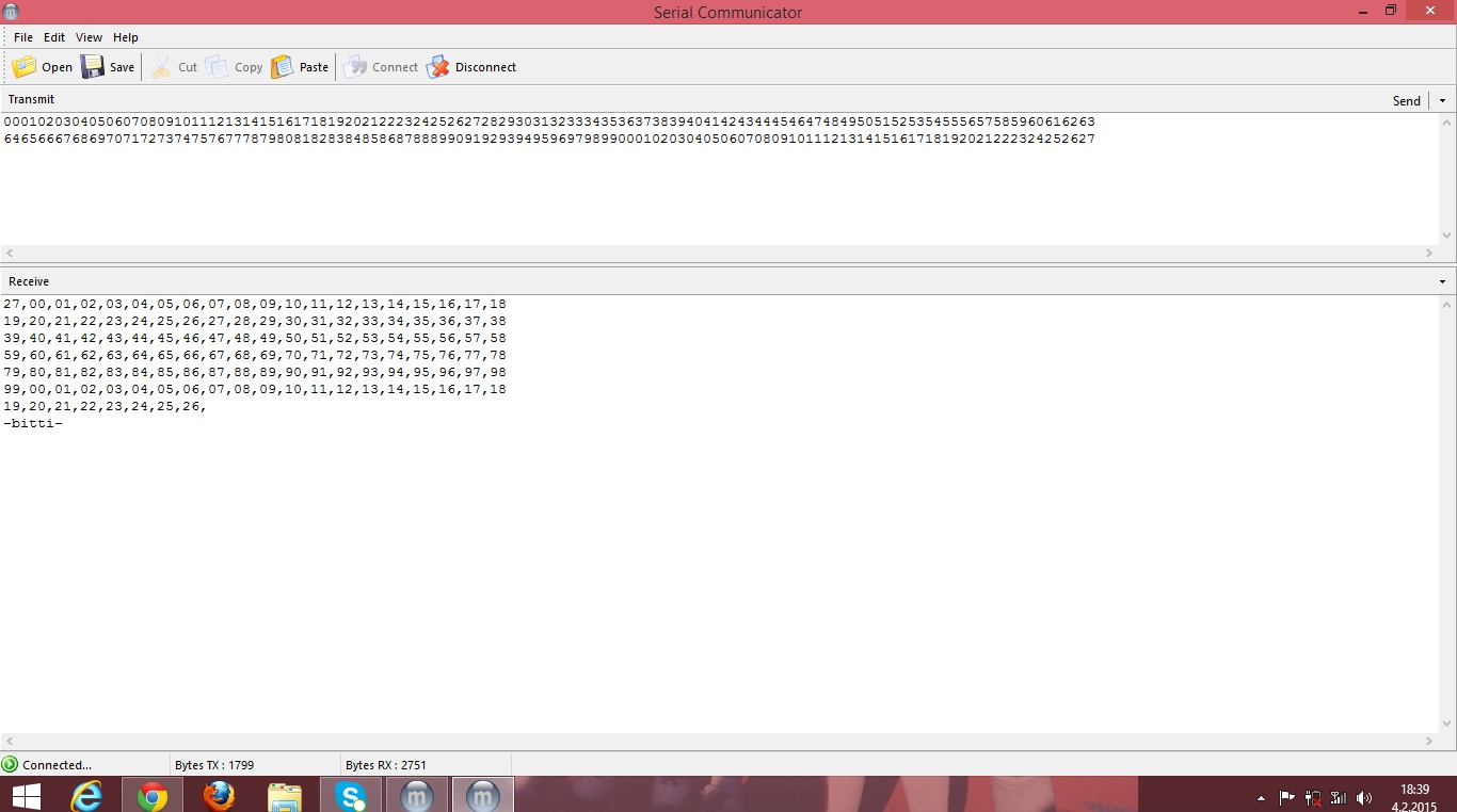

    i send 64 bytes from pc in total and it sends me back 64 bytes- no problem at this point... but the row, array is mixed
    thanks...

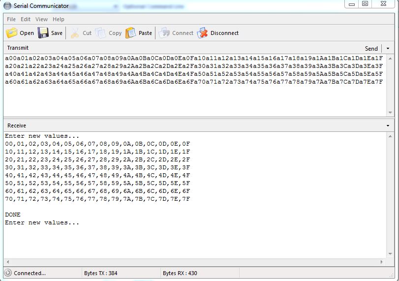

    I just verified the method here and it works just fine, with 128 values.
    Here's the code I used:
    i       VAR BYTE
    j       VAR BYTE
    Array   VAR BYTE[128]
    PAUSE 3000
      GOSUB ClearArray
      HSEROUT["Enter new values...", 13]
      For i = 0 to 127
          HSERIN[WAIT ("a"), HEX2 Array[i]]
      NEXT
      ' Send values back, the Array[i-1] and i//16 stuff is just there
      ' to format the output a little better, for readabillity.
      For i = 1 to 128
        HSEROUT[HEX2 Array[i-1]]
        IF i // 16 = 0 THEN
            HSEROUT[13]
            HSEROUT[","]
      NEXT
        HSEROUT[13, "DONE", 13]
      Goto Main
    ClearArray:
        For i = 0 to 127
            Array[i] = 0
        NEXT
    And here's the result:
    Name:  HEX string.jpg
    Now, this was on a 18F25K20 running at 64MHz, which is 16 times faster than 4MHz. On the other hand I used 115200 baud which is 12 times faster than 9600. If it refuses to work at your end then, as a test, decrease the baudrate or increase the oscillator speed.

    strange, weird things happen in my terminal program. i use Bray's terminal as a communicator but the results are so silly as in my last post. i tried pic basic pro's serial communicator like Henrik and the results are totally different. everything looks tidy and the results are the same as what they should be... BUT sometimes-rarely- last byte of array stays in rcreg and it became the first byte of next packet how can i overcome this problem?
    for example:
    eeprom:24c512
