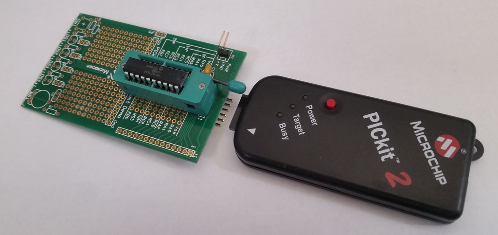

    Here is what I use to program multiple chips... I can do one chip in about 5 sec
    >drop in a new chip in the ZIF socket
    >clamp the ZIF socket
    >hit Enter to program
    >release the ZIF lever
    >drop the programmed chip into a static safe bag (I use a metalized static bag opened up on the counter and just tip the programmer over to drop the chip into the bag)
    >repeat...
    All in around 5 seconds
    Just get yourself an appropriately sized ZIF (zero insertion force) socket and a little bit of perf board and a header strip or whatever you need for your programmer and go to town

    Default Re: HI speed programmer
    Does the PICKit2 require power from the pcb?
    Oct 2009
    Utah, USA
    427
    No external power required... The PICkit2 is totally USB powered.
    I can program 8, 14 and 20 pin pics with my setup.
    I used the Microchip LowPinCount demo board and because the ZIF socket covered up where the header strip normally would be, I just soldered them in on the bottom side instead.
    Also the PICkit2 has a PushButton on it that you can enable to initiate the program cycle (from inside the PICkit application)
    or you can just hit enter to do the same thing.
    There is a PICkit3 version that I do not have and can not comment on how it compares to the PICkit2 (others may be able to chime in on how they compare).
    Make sure your specific PIC is supported if you are considering the PICkit 2 or 3
