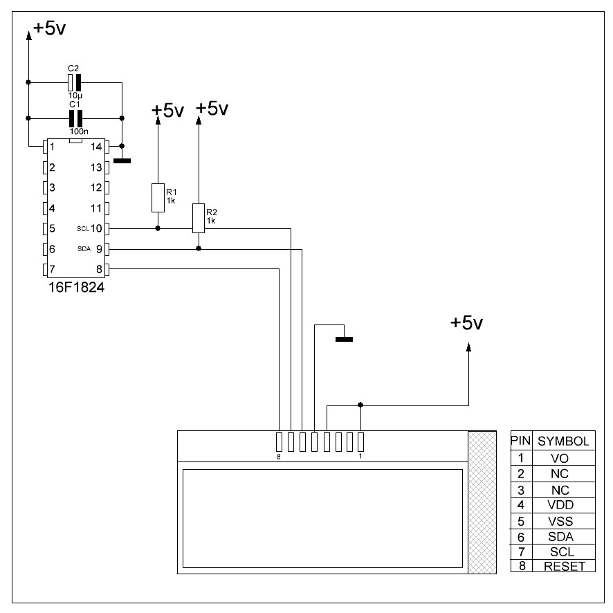

    I'm back with another problem. Its first time when I work with I2C .
    I have a 1x LCD with 8 pins, I suppose that have a controller ST7036i or ST7032i (pin2, pin3 = NC) and also I have a LCD with 7 pins , TM202SIFSUGWA with ST7036i controller(pin2 = NC) . I tried to display a text but I have nothing on LCD.
    I used this schematic:

    It might be working but the lcd might not have high enough contrast.
    Usually, V0 is not VDD.
    Try a 20K variable resistor, V0 to center pin, VDD to one side, GND to other side.
    Now turn resistor and look at LCD for changes.
    Edit: also increase pause between writes to lcd in case it needs more time. Try PAUSE500 to test.
    Default Re: 16LF1824 strange problem
    You still need VDD to pin 4.

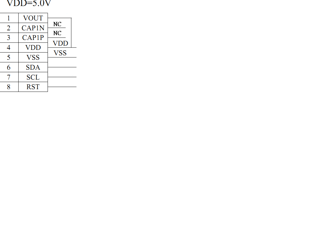

    Thx Robert for suggestion ..I tried like schematic, but nothing...
    A question : on this LCD type I must see a dots when I play cu variable resistor ? Or first time ,lcd must be initialized ?

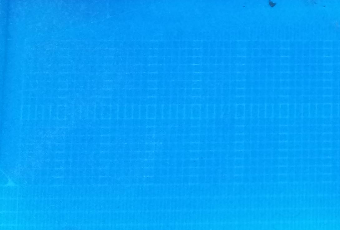

    You can start by seeing the "squares" where the characters will appear darken. Once you get something going - adjust to taste.

    I am just curious. Did you manage to run LCD with the pinout from MIDAS? I mean the pinout you mentioned at beginning of this thread.

    Can you include a high res picture of your display?

    I tried ...
    if I write the PIC and turn ON the board with Vcc = 3,6V I see on LCD this:
    ...then I move the Vcc to 5V, on LCD appear :
    In this case I can set a contrast from 5k potentiometer on V0 LCD pin, but I see only full dots.
    If I write the PIC and turn ON the board with Vcc = 5v, I see nothing on LCD. No effect if I down the voltage to 3,6V !

    I2C interface
    It just only could write Data or Instruction to ST7032 by the IIC Interface.
    It could not read Data or Instruction from ST7032 (except Acknowledge signal).
    SCL: serial clock input
    SDA: serial data input
    Slaver address could only set to 0111110, no other slaver address could be set
    I found this data sheet at http://www.farnell.com/datasheets/1669635.pdf
    The pinouts are the same as your display
