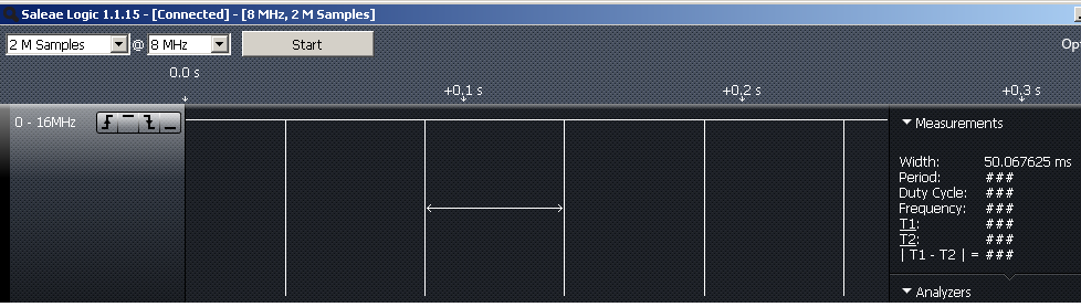

    5 TICK Timer
    OSC 16MHz (4MHz+PLL) 50ms
    OSC 32MHz (8MHz+PLL) 25ms
    OSC 64MHz (16MHz+PLL) 12.5ms
    I can't help but feel I'm doing something wrong, it's just too proportional a variance. If the Saleae probe would miss pulses, there wouldn't be a regular pattern.

    Quote Originally Posted by longpole001 View Post
    each 100th is 10ms on the i/o debug section btw
    My output pin changes state every 2.5ms at 64MHz.

           IF LATD.3 = 0 THEN           ' debug
              LATD.3 = 1
              LATD.3 = 0
      if EL_ticks // T1PS = 0  THEN      ' if modulas of tips (4) = 0
              LATD.3 = 1
              LATD.3 = 0

    Default Re: Elapsed timer not working as expected at 64MHz
    Yes, I'm an idiot.
    T1CON becomes 00000001 once it is STARTED! D'OH!
    Sheldon,
    It's not perfect, I'm missing some pulses on the Saleae probe, but it's sticking to a 2.5ms tick as you describe in your Elapsed include comment.
    Name:  Saleae 64MHz 2-5ms.PNG
    EDIT: I just noticed that the skipped pulse happens at every 4 ticks.
    And that skipped pulse is between 20-21uS.
    EDIT SOME MORE: Got it, it's that 2nd LED toggle. I commented it out and now I have a regular 2.5ms pulse.

    New field OneHundreth (10ms) replaces Tick (2.5ms at 64MHz).
    Name:  Saleae 64MHz new.PNG
    (Remove .TXT suffix)
    Elapsed_INT-18_64MHz.bas.txt
    2,696

    you may like to re-examine that I just tried it on a pic1845k20 @64 MHz and the int is 2.5mS as expected , sheldons mod just adds 100th doesn't it
    the ticks only inc on every 4th interrupt
    What happens when you start/stop the timer after 5 ticks using the original include?
    I get this using the new include:
    Name:  Saleae 64MHz 5 ticks.PNG
    MainProgram:
        if T1CON.0 = 0 then
            PortD.3 = 1
            GOSUB StartTimer
        if OneHundreth = 5 then
            PortD.3 = 0
            GOSUB StopTimer                    ' Stop the Elapsed Timer
            GOSUB ResetTime                     ' Reset Time to  0d-00:00:00.00
        goto MainProgram
    2,696
