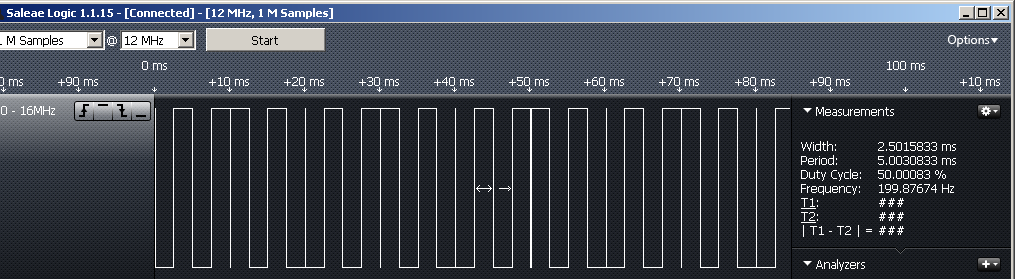

    Has anyone else had problems using DT's Elapsed Timer at 64MHz?
    When I run a 18F44K22 at 64MHz, 99 TICKS = .247 second.
    Name:  Saleae 99 TICKS 64MHz.PNG
    When I run at 16MHz, 99 TICKS = .988 second.
    Name:  Saleae 99 TICKS 16MHz.PNG
    It's as if the timer runs at a default 16MHz when the PIC is at 64MHz (exactly 1/4 speed).

    I bet this is my Saleae probe biting me in the nose again; not being able to run it fast enough.
    The interrupt is working faster, I'm probably missing signals.
    Name:  Saleae 64MHz VS 16MHz.PNG
    EDIT: And I notice I didn't align the marker the same way on Probe 1 - Port = 1 / 0, but it's the same interval as described in the WIDTH; 0.250uS, I just rechecked.

    It's not perfect, I'm missing some pulses on the Saleae probe, but it's sticking to a 2.5ms tick as you describe in your Elapsed include comment.
    Name:  Saleae 64MHz 2-5ms.PNG
    EDIT: I just noticed that the skipped pulse happens at every 4 ticks.
    And that skipped pulse is between 20-21uS.
    EDIT SOME MORE: Got it, it's that 2nd LED toggle. I commented it out and now I have a regular 2.5ms pulse.

    Quote Originally Posted by longpole001 View Post
    each 100th is 10ms on the i/o debug section btw
    Yup, I get 10ms if I comment out the 1st LED toggle.
    Attachment 7542
    I understand quickly as long as you explain 10 times.
    Default Re: Elapsed timer not working as expected at 64MHz
    Well that toggle from Sheldon confirms DT's is not working perfectly at 64MHz.
    I get 2.5ms on each LED toggle.
    T1PS  CON EXT
    ClockCount:
    @ RELOAD_TIMER                   ; Reload TIMER1
        Ticks = Ticks + 1
           IF LATD.3 = 0 THEN           ' debug
              LATD.3 = 1
              LATD.3 = 0
        IF Ticks = 100 THEN
           Ticks = 0
           T1Post = T1Post + 1
           IF T1Post = T1PS THEN
               T1Post = 0
               Seconds = Seconds + 1
               SecondsChanged = 1
               IF Seconds = 60 THEN
                  Seconds = 0
                  Minutes = Minutes + 1
                  MinutesChanged = 1
               IF Minutes = 60 THEN
                  Minutes = 0
                  Hours = Hours + 1
                  HoursChanged = 1
               IF Hours = 24 THEN
                  Days = Days + 1
                  DaysChanged = 1
                  Hours = 0
    @ INT_RETURN                     ; Restore context and return from interrupt
    Thanks a lot Sheldon for having figured this one out.

    DT's Elapsed include doesn't work perfectly at 64MHz (1 tick = 2.5ms), Sheldon's modified version does (1/100th = 10ms). Sheldon has added a new variable. I'm cleaning up the new include now to put it on the forum, somewhere.
    New version of Darrel Taylor's Elapsed include for 64MHz:

    New field OneHundreth (10ms) replaces Tick (2.5ms at 64MHz).
    Name:  Saleae 64MHz new.PNG
