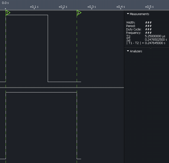

    Has anyone else had problems using DT's Elapsed Timer at 64MHz?
    When I run a 18F44K22 at 64MHz, 99 TICKS = .247 second.
    Name:  Saleae 99 TICKS 64MHz.PNG

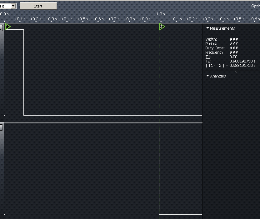

    When I run at 16MHz, 99 TICKS = .988 second.
    Name:  Saleae 99 TICKS 16MHz.PNG
    It's as if the timer runs at a default 16MHz when the PIC is at 64MHz (exactly 1/4 speed).

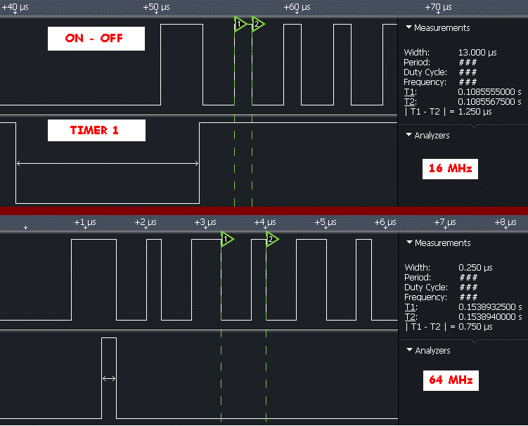

    I bet this is my Saleae probe biting me in the nose again; not being able to run it fast enough.
    The interrupt is working faster, I'm probably missing signals.
    Name:  Saleae 64MHz VS 16MHz.PNG
    EDIT: And I notice I didn't align the marker the same way on Probe 1 - Port = 1 / 0, but it's the same interval as described in the WIDTH; 0.250uS, I just rechecked.

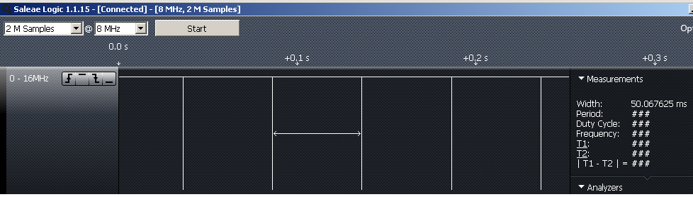

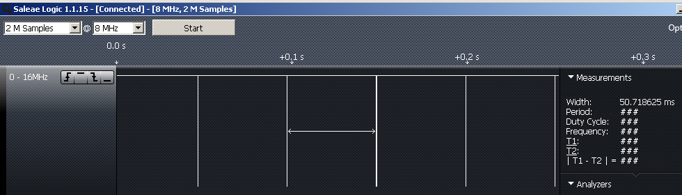

    5 TICK Timer
    OSC 16MHz (4MHz+PLL) 50ms
    OSC 32MHz (8MHz+PLL) 25ms
    OSC 64MHz (16MHz+PLL) 12.5ms
    I can't help but feel I'm doing something wrong, it's just too proportional a variance. If the Saleae probe would miss pulses, there wouldn't be a regular pattern.

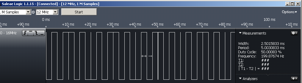

    Default Re: Elapsed timer not working as expected at 64MHz
    for 64mhz
    each tick should be 2.5ms , to confirm the internal osc trim i enable a i/o pin to check its pulse per tick rate , it not the best way but it showed me that the most the time the internal osc needed some adj to ensure that it was as close as possable to 2.5ms
    here is a snip of modifed code for the timer, i left the asm as it stands, but cos i wanted the 100th sec reading and the same structure of code , i changed / removed the t1post varable and used the MOD
    EL_Ticks = EL_Ticks  + 1    ; each tick is 2.5ms

    My output pin changes state every 2.5ms at 64MHz.
    Yes, I'm an idiot.
    T1CON becomes 00000001 once it is STARTED! D'OH!
    Sheldon,
    It's not perfect, I'm missing some pulses on the Saleae probe, but it's sticking to a 2.5ms tick as you describe in your Elapsed include comment.
    Name:  Saleae 64MHz 2-5ms.PNG
    EDIT: I just noticed that the skipped pulse happens at every 4 ticks.
    And that skipped pulse is between 20-21uS.
    EDIT SOME MORE: Got it, it's that 2nd LED toggle. I commented it out and now I have a regular 2.5ms pulse.

    Quote Originally Posted by longpole001 View Post
    each 100th is 10ms on the i/o debug section btw
    Yup, I get 10ms if I comment out the 1st LED toggle.
    Attachment 7542

    New field OneHundreth (10ms) replaces Tick (2.5ms at 64MHz).
    Name:  Saleae 64MHz new.PNG
    (Remove .TXT suffix)
    Elapsed_INT-18_64MHz.bas.txt
    2,721

    What happens when you start/stop the timer after 5 ticks using the original include?
    I get this using the new include:
    Name:  Saleae 64MHz 5 ticks.PNG
    MainProgram:
        if T1CON.0 = 0 then
            PortD.3 = 1
            GOSUB StartTimer
        if OneHundreth = 5 then
            PortD.3 = 0
            GOSUB StopTimer                    ' Stop the Elapsed Timer
            GOSUB ResetTime                     ' Reset Time to  0d-00:00:00.00
        goto MainProgram
    2,721
