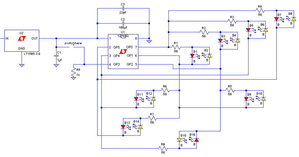

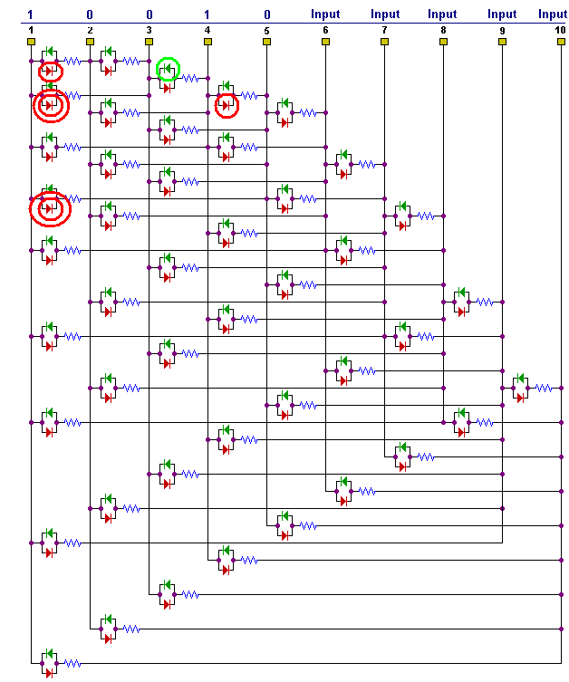

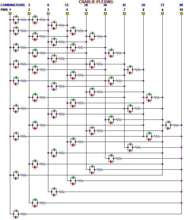

Hi Richardby using multiplexing you can " light' any or even all the leds its all about persistence of vision
to light them all

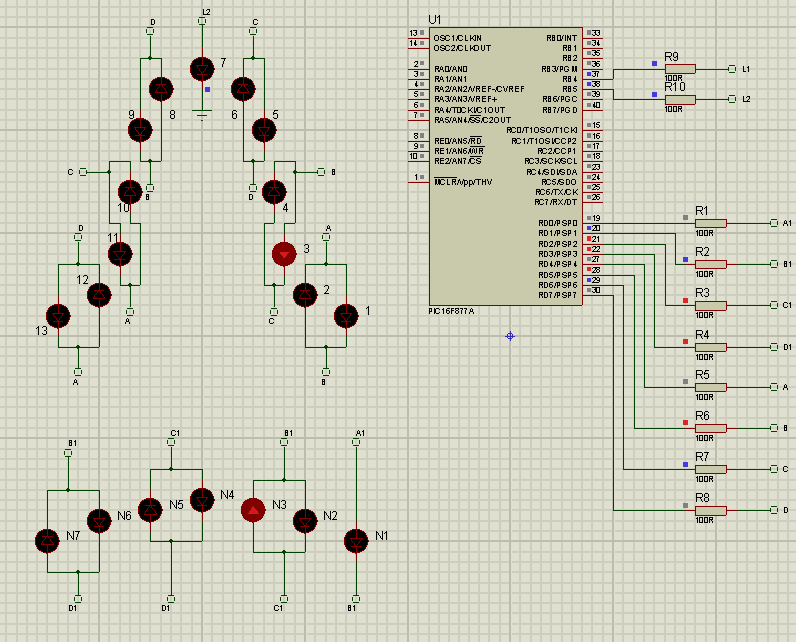

Just ran that short piece of code. All the Leds are lit.
It appears to be down to one line
So pausing the code for 1.2 milliseconds makes them look like they are all on?Code:pauseus 1200
