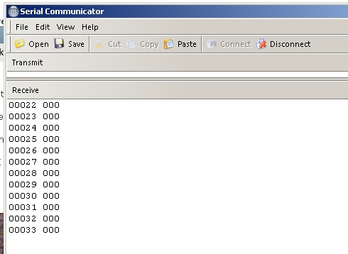

    For a test, I want to read the first three bytes of the tag's ID and print them serially out.
    But up to now, I can't make the RFID module "read" something. I'm not sure about my connections and about the different timings and whatever I have to do to "start" the read process.Name:  2017-10-07-Serial Communicator.jpg

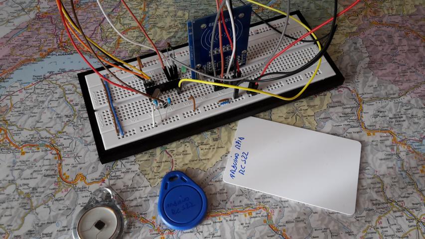

    Does anyone have a good idea to get me started reading some data?
    My test project:

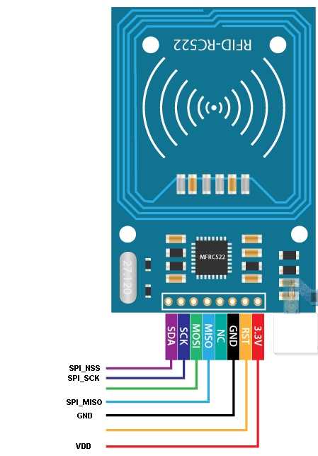

    The RFID module I'm using is this one for ARDUINO and the connections I used:

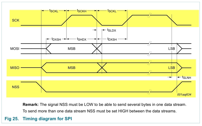

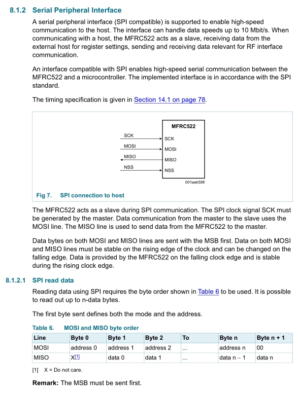

    Name:  SPI theory.jpg
    Name:  SPI Timing.jpg

    I'm confused, where do you see that shifiting in three bytes like that should give you the three first byte of a cards S/N number?
    It looks to me as if the RFID reader chip implements a "proper" SPI slave meaning you have to shift data out at the same time as you shift data in. If that's the case SHIFTIN/SHIFTOUT won't work because it can only shift data out OR shift data in, it can't do it simultanously.
