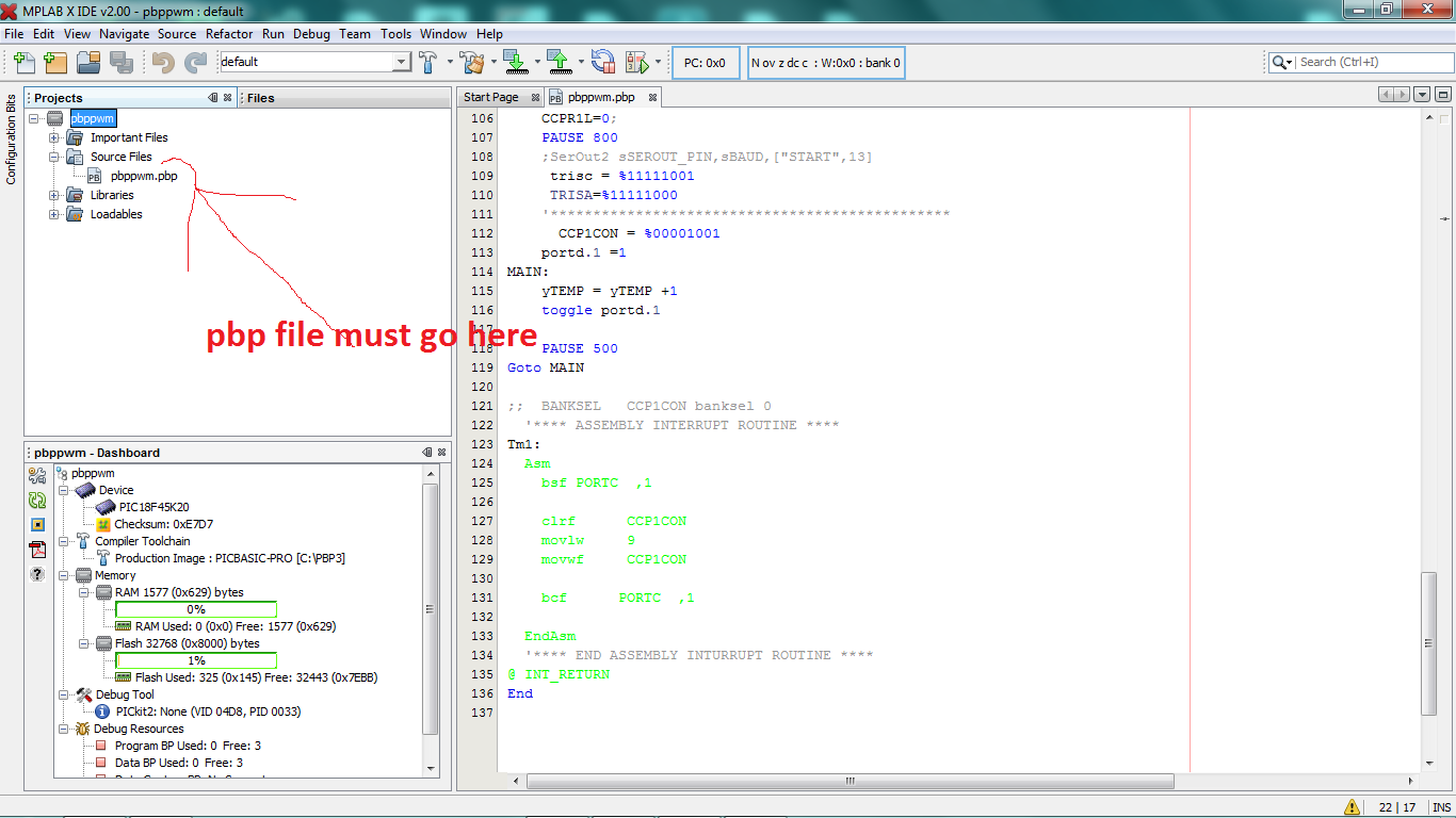

    its pouring rain here today so I had another go a getting pbp3 to work in labx, put labx ver 2 on the laptop
    added the pbp2.6 and pbp3 tool chains and guess what . it works
    I can now source debug a pbp3 project (pic18's only)
    seems in previous attemps I created my source files in the wrong spot
    see attached
