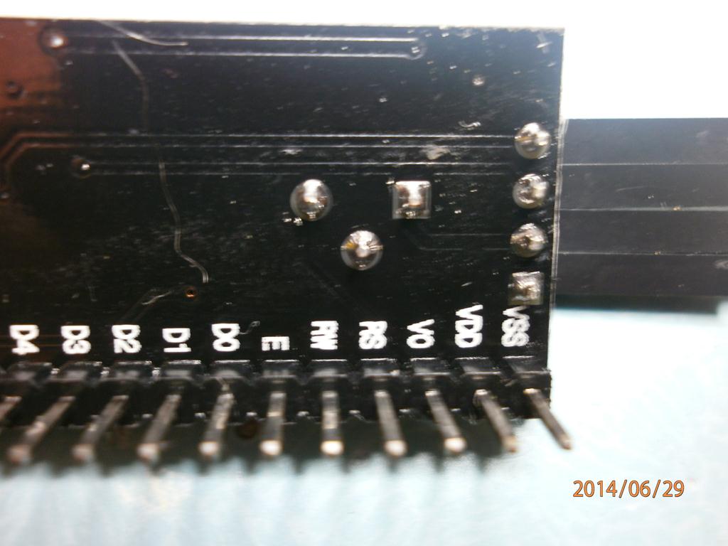

    Hi Steve,
    I received the new display just now.
    It is equipped with the PCF 8574T.
    It is connected to the QC2004A display in the following way:
    pin_4 p0 > RS
    pin_5 p1 > RW
    pin_6 p2 > enable
    pin_7 p3 > Backlight
    pin_9 p4> data4
    pin_10 p5 > data5
    pin_11 p6 > data6
    pin_12 p7 > data7
    It is different wrt the one I had before: it has a different connections between the PCF and the LCD.
    I will be ready for testing tomorrow or monday: please suggest me what trials to do just to start.
    Thanks for all
    Ambrogio

    I wrote this small program and I am able to control Backlight :
    DEFINE OSC 40 ' 10 MHz XTAL AND X 4 INTERNAL PLL
    DEFINE I2C_SLOW 1
    C VAR portd.3 ' S_CLOCK
    D VAR portd.2 ' S_DATA
    ADDR VAR BYTE
    ADDR = %01001110 ' dec 78 , hex 4E
    CMD VAR BYTE
    LCD_CMD VAR BYTE
    E VAR LCD_CMD.BIT2
    RS VAR LCD_CMD.BIT0
    E=0:RS=0
    LCD_CMD = 0
    PAUSE 1000
    MAIN:
    I2CWRITE D, C, ADDR, [%00000000] ' bck_lt= off
    PAUSE 200
    I2CWRITE D, C, ADDR, [%00001000] ' bck_lt=on
    PAUSE 200
    GOTO MAIN
    The I2C address is new.
    Now, my LCD has 20 chrs X 4 lines.
    The PCF controls the LCD using the upper four bits of its output port.
    I have to initialize the LCD in four bit mode , four lines at the required PCF port pins.
    How could I do that ?
    Ambrogio

    I have checked the PCF to LCD connection :
    bit0 = RS
    bit1 =RW
    bit2 =EN
    bit3 =bck_lt
    bit4 =D4
    bit5 =D5
    bit6 =D6
    bit7 =D7
    D0 to D3 of the LCD : there is no connection at all.
    Ambrogio

    I am not able to findout the detailed spec for the QC2004A display. I can tell it is working well using the standard PBP connection diagram.
    I am posting a general spec for LCD addressing ( attached ).
    I did a very bad experience with the PCF expander board that was attached to the LCD: the trim pot that should adjust the contrast of the display has the cursor connected to ground and one side connected to 5VDC. I did turn it just to be sure of the contrast setting and I got a short circuit of the 5Vdc to ground when turned fully clockwise. The result is that my ICD2 programmer smoked and it is no longer working. I have attached the photo of the PCF expander to warn about this item: there is a very very gross design error on it.
    I am looking to find a new pic programmer to buy: what do you recommand to me ? Is the pickit3 really good ?
    I have a pic16f877 to replace on the ICD2 programmer but I do not have any possibiliity to program it with the required bootloader... I will ask someone tomorrow !
    I really hope to test your programs soon. I will let you know.
    I want to thank you once again for the help you are giving to me .
    Ambrogio
