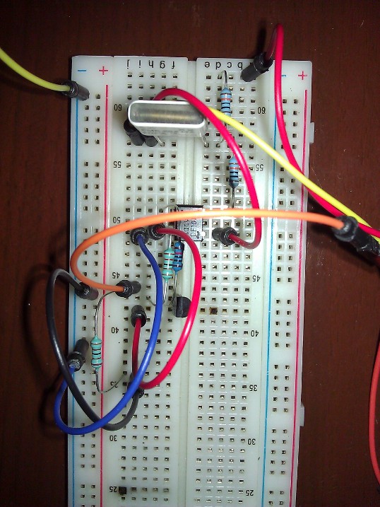

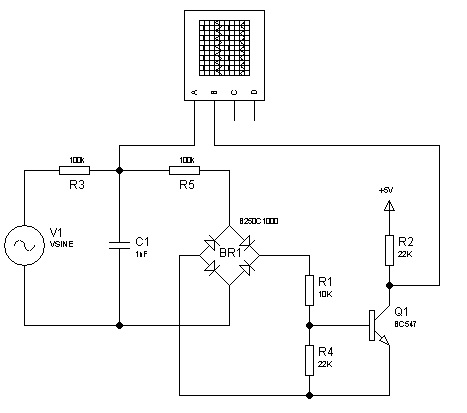

    I'm upto a triac control circuit . So , in order to control the triac triggering angle we need to detect the zero crossing points .. I've made the attached circuit schematic on a breadboard but I'm having too weird problem about the full wave rectified sine wave .. The rectified wave can not reach to zero cross twice but only once during a period and plots an unintended line as seen on the attached picture .. I've changed the circuit components for a thousands of times including the resistors , capacitors , bridge rectifiers , transistors even the breadboard ... The rectified wave even acts same on a single load resistor ...
    What could the problem be ?

    looks like your ac signal earth reference is biased one forward diode voltage above earth.

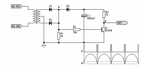

    you need something like this

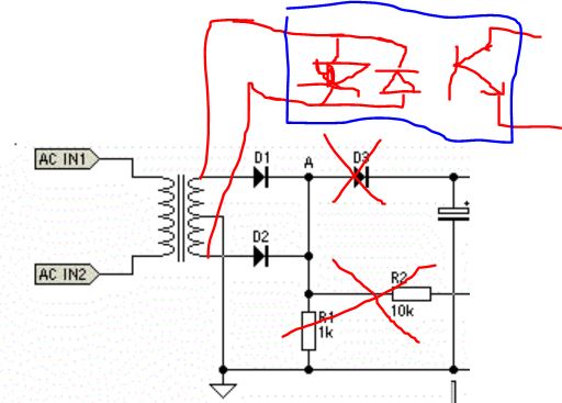

    I use 'ac opto' to get 0xing. vary R3 to change width of the zero areaName:  zero xing.JPG
    oh, add series resister to opto input !!

    I use 'ac opto' to get 0xing. vary R3 to change width of the zero areaAttachment 7388
    Thanks for your replies guys .
    To amgen ; Why would we still need the diodes and the cap since the AC opto and a series resistor are sufficient to detect the zero crosses ?
    I mean the following link would have sufficied I suppose ?
    http://i.stack.imgur.com/sw3mO.png
    Default Re: Rectified wave problem
    thought that was part of your power supply stuff !! otherwise then not needed.
