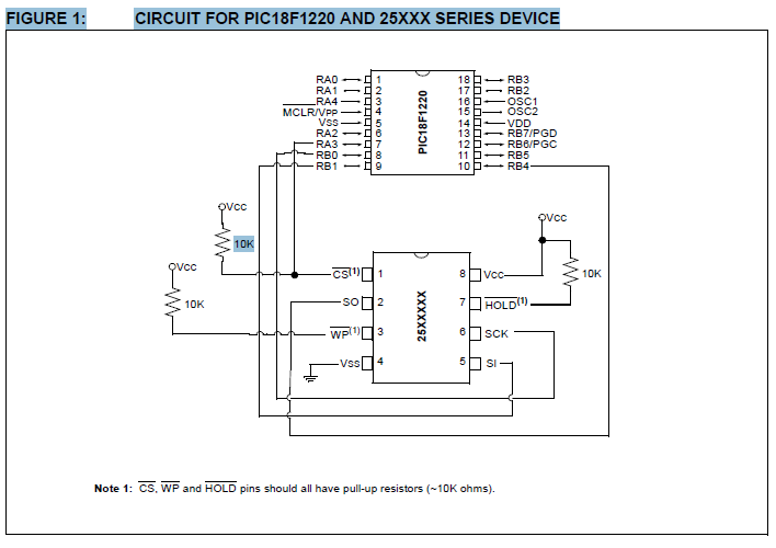

    Default Re: LAB1X sample code not working with 25LC640.
    Here is an app note http://ww1.microchip.com/downloads/e...tes/01018A.pdf
    which contains a wiring diagram.
    I hope this gives you some clues as to why the code is not working.
    Does not works anyway....
