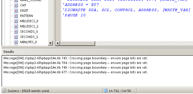

    I'm using a PIC16F1939 to control a RTC chip with I2C. I'm using PBP2.60. The 16F1939 has 16384 words of programming memory. So whenever I compile the big program that I'm playing with I get the normal message,
    Everything good so far. So, whatever code I add to my program I get the above "Crossing page boundary...." messages. Now, if I add these lines of code,

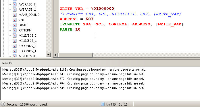

    SYMBOL SCL = PORTC.3            'EEPROM CLOCK PIN
    SYMBOL SDA = PORTC.4            'EEPROM DATA PIN
    ADDRESS     VAR BYTE
    CONTROL     VAR BYTE: CONTROL = %11011111
    WRITE_VAR = %01000000
    'I2CWRITE SDA, SCL, %11011111, $07, [WRITE_VAR]
    ADDRESS = $07
    I2CWRITE SDA, SCL, CONTROL, ADDRESS, [WRITE_VAR]
    PAUSE 10
    Then, I always get the following messages,
    The program seems to be working fine. But, I have no idea why I get this "1183 : Crossing page boundary..." message only when I use the I2CWRITE. I'm pulling my hair out trying to figure this out . Any help will be greatly appreciated.

    Thanks Richard, but why this "1183 : Crossing page boundary..." message appears only when I use the I2CWRITE command? That is what I don't understand. Is this a normal compiling message?

    755
    Default Re: I2CWRITE Issue at Compiling Time
    Yes. It appears only when your code is larger than 1K, 2K etc...

    I know it's a normal thing. The question is that whatever code I add to my program I get the usual crossing page boundary messages. I can get the programming memory nearly full and I get the messages in the first picture posted above. Only and only when using I2CWRITE is that I get the "1183 : Crossing page boundary...".

    I do believe that the '1183' refers to a line number in the assembled code. The number changes depending upon which libraries are called and where the page crossing occurs in the listing.

    Hi, that makes sense. Because it only happens when using the I2CWRITE command.
