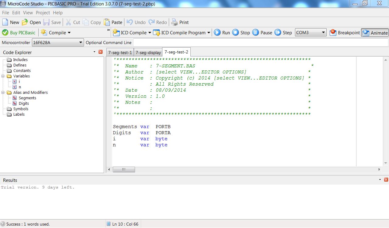

    New to PIC Basic programming. I'm starting with examples for my PIC16F877A development board.
    I copied the 7 segment display example from here:
    http://melabs.com/samples/PBP-mixed/7segment.htm
    The first time I compiled it (at work), it compiled fine.
    I went home and changed a port assignment and it failed to compile.
    Next day I tried again at work, it failed to compile on exactly the same machine I had successfully compiled it on the previous day.
    I re-copied from the site and cut it down to just the erroring code to keep it simple and now I have two visually identical bits of code, one that compiles and one that doesn't.
    Now I could run with the one that does but as a beginner I really want to know what the hell is going on.
    Please see the attached screenshots.
    Cheers,
    Wilson.

    Default Re: Bizarre compile errors
    One is compiling for a 12F, the other for a 16F. There is no PORTB in a 12F683, hence the issue.

    13
    Doh!
    Wilson.
