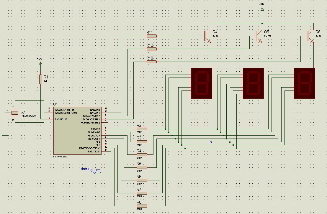

    Hello everybody.
    I'm very new to pic, beeing learning for almoast one year on my own.
    I've been reading some time for a tachometer, and all i've found is info about tacho's for high speed.
    I'm trying to make a tacho for 20 to 60 rpm. I gathered the hardware, it's based on the 16f628a, 4mhz crystal and three 7 seg display common anode.
    I'm doing this so i can be shure that a line of 7 conveyors are in sync, at 36 rpm. I need to be shure that the conveyors are running at 36 rpm, not 35,5 or 36,5. So i added three 7seg display to do the decimals.
    The rpm are checked by means of an ir emiter/receiver.
    I've made a circuit based on a counter from the book "PIC Basic Projects 30 Projects using PIC BASIC and PIC BASIC PRO", "Dual 7-segment LED event counter".
    The code is being simulated on proteus and it says that the pic is under excessive load, and it doesn't work.
    The code:

    By the way i use PBP 2.60 and microcode studio 4, and the schema goes like this:

    Default Re: Slow speed tachometer
    a few thoughts :-
    1, INTCON.7 "GIE" and INTCON.6 "PEIE" probably need to be set
    2, this piece of code can never execute because its orphaned
    RESUME ' Return to main program
    ENABLE ' Enable interrupts
    TMPlowbyte = 0 ' Variable reset
    PIR1.0=0 ' Reset TMR1's Interupt Flag
    TMR1Overflow = 0 ' Reset TMR1 Overflow counter
    END ' End of program
    3, the " on interrupt " latency is variable and unpredictable and is unlikey to give accurate results.
    dt interrupts is vastly better.
    4, for your purposes rpm measurement using "pulsin" is far simpler to do and a lot easier to get working.
