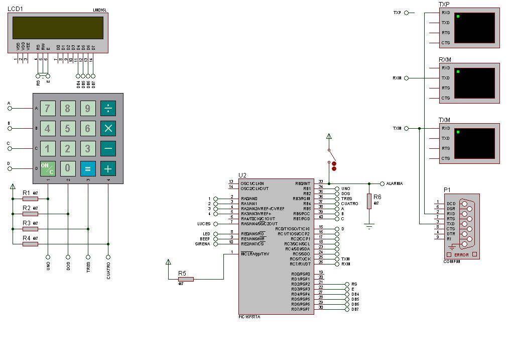

Vallamos a un ejemlpo mas interesante... una alarma con teclado, display lcd y comunicacion gsm
include "modedefs.bas"
define OSC 4
ADCON1 = %00001111 ;el puerto A.0 es conversor los demás Digitales
TRISA = %00001111
TRISB = %00011111
TRISC = %10000000
TRISD = %00000011
TRISE = %00000000
;*************** DISPLAY LCD ****************
DEFINE LCD_DREG PORTD
DEFINE LCD_BITS 4                ;DB4-PORTD.4
DEFINE LCD_DBIT 4                ;DB7-PORTD.7
DEFINE LCD_RSREG PORTD
DEFINE LCD_RSBIT 2               ;RS-PORTD.2
DEFINE LCD_EREG PORTD
DEFINE LCD_EBIT 3                ;E-PORTD.3
DEFINE LCD_LINES 2               ;LCD DE 2 LINEAS
POS1 var Byte
POS2 var Byte
POS3 var Byte
POS4 var Byte
POS1 = $C0 ' Ver figura 6.13
POS2 = $C1 '
POS3 = $C2 '
POS4 = $C3
LCDOUT $FE,$40,$00,$00,$10,$0F,$0F,$0D,$18,$10 ' Palabra 0 de la CGRAM
LCDOUT $FE,$48,$04,$0E,$1F,$1C,$1C,$1C,$06,$05 ' Palabra 1 de la CGRAM
LCDOUT $FE,$50,$00,$00,$10,$0F,$0F,$0D,$04,$06 ' Palabra 2 de la CGRAM
LCDOUT $FE,$58,$04,$0E,$1F,$1C,$1C,$1C,$08,$18 ' Palabra 3 de la CGRAM
LCDOUT $FE,$60,$04,$0E,$1F,$07,$07,$07,$02,$03 ' Palabra 4 de la CGRAM
LCDOUT $FE,$68,$00,$00,$01,$1E,$1E,$16,$04,$0C ' Palabra 5 de la CGRAM
LCDOUT $FE,$70,$04,$0E,$1F,$07,$07,$07,$0C,$14 ' Palabra 6 de la CGRAM
LCDOUT $FE,$78,$00,$00,$01,$1E,$1E,$16,$03,$01 ' Palabra 7 de la CGRAM
;**************** TECLADO ******************
UNO      VAR PORTB.1 ;nombres para los pines de las columnas
DOS      VAR PORTB.2
TRES     VAR PORTB.3
CUATRO   VAR PORTB.4
A        VAR PORTB.5 ;nombres para los pines de las filas
B        VAR PORTB.6
C        VAR PORTB.7
D        VAR PORTC.0
;*************** SALIDAS ********************
LEDROJO      VAR PORTE.0
LEDVERDE      VAR PORTE.1
SIRENA   VAR PORTE.2
SONIDO    VAR PORTA.5
;*************** VARIABLES ******************
BANDERA VAR BYTE
BANDERA1 VAR BYTE
BANDERA2 VAR BYTE
NUMERO   VAR BYTE ;variable número para almacenar la tecla pulsada
R        VAR BYTE ;variable r para hacer repeticiones
SET1 VAR BYTE
SET2 VAR BYTE
SET3 VAR BYTE
SET4 VAR BYTE
dato VAR WORD ;crear variable dato para guardar
seguridad_ON var byte
On Interrupt GoTo ZONA ' Define el vector de interrupción.
INTCON = %10010000 ' Activa el inspector de interrupciones y
' habilita la interrupción RB0/INT.
LCDOUT $FE,1
LCDOUT "INICIO SISTEMA"
LCDOUT $FE,$C2,"DE SEGURIDAD"
PAUSE 1000
GOSUB perroGUARDIAN
LCDOUT $FE,1
BANDERA = 0
INICIANDO:
FOR R=1 TO 2
HIGH LEDROJO:HIGH LEDVERDE:HIGH SONIDO
PAUSE 200
LOW LEDROJO:LOW LEDVERDE:LOW SONIDO
PAUSE 100
NEXT
LCDOUT $FE,$C0, 0
;******************GUARDAR LA CLAVE EN LA MEMORIA EEPROM************************
EEPROM 0,[1,2,3,4]
ARRANQUE:
PAUSE 500
LCDOUT $FE,1
LCDOUT "(*)S/N (#)Config"
LCDOUT $FE,$C0,"(0) PRUEBA GSM"
BANDERA = 0
LOW A
IF UNO=0 THEN NUMERO=1:RETURN
IF DOS=0 THEN NUMERO=2:RETURN
IF TRES=0 THEN NUMERO=3:RETURN
HIGH A
LOW B
IF UNO=0 THEN NUMERO=4:RETURN
IF DOS=0 THEN NUMERO=5:RETURN
IF TRES=0 THEN NUMERO=6:RETURN
HIGH B
LOW C
IF UNO=0 THEN NUMERO=7:RETURN
IF DOS=0 THEN NUMERO=8:RETURN
IF TRES=0 THEN NUMERO=9:RETURN
HIGH C
LOW D
IF UNO=0 THEN mensajeACTIVADO
IF DOS=0 THEN MODEM
IF TRES=0 THEN GRABAUNO
HIGH D
PAUSE 25
GOTO ARRANQUE

' si POS4 = $CF salta a la etiqueta "RETRO"
goto perroguardian ' Salta a la etiqueta "inicio"
' Antes de retroceder nos aseguramos de que las figuras E,F,G y H tengan una
' posición inicial en la pantalla LCD:
RETRO:
POS1 = $CF
POS2 = $CE
POS3 = $CD
POS4 = $CC
RETROCEDE:
LCDOUT $fe, 1 ' Limpia la pantalla LCD
LCDOUT $FE,POS1, 7 ' Muestra Palabra 7 en la LCD
LCDOUT $FE,POS2, 6 ' Muestra Palabra 6 en la LCD
Pause 300
LCDOUT $FE,POS3, 5 ' Muestra Palabra 5 en la LCD
LCDOUT $FE,POS4, 4 ' Muestra Palabra 4 en la LCD
Pause 300
' Disminuimos la posición de cada símbolo en la pantalla para dar el efecto
' de movimiento en sentido contrario:
POS1 = POS1 - 3
POS2 = POS2 - 3
POS3 = POS3 - 3
POS4 = POS4 - 3
If POS4 < $C0 Then REINICIA ' Pregunta si llega al tope Izquierdo de la LCD
GoTo RETROCEDE
' Nos aseguramos de que las figuras A,B,C y D tengan una posición inicial en la
' pantalla LCD:
REINICIA:
POS1 = $C0
POS2 = $C1
POS3 = $C2
POS4 = $C3
return ' Se repite el proceso saltando a la etiqueta "inicio"
DISABLE
ZONA:
IF BANDERA = 1 THEN
HIGH SIRENA
BANDERA1 = BANDERA1 + 1
LOW SIRENA
IF BANDERA1 > 6 THEN BANDERA1 = 0
IF BANDERA = 1 AND BANDERA1 < 3 THEN
PAUSE 100
serout PORTC.6,T9600,["AT+CMGR=1",10,13]
PAUSE 500
SEROUT PORTC.6,T9600,["AT+CMGD=1",10,13]
SEROUT PORTC.6,T9600,["AT+CMGD=2",10,13]
SEROUT PORTC.6,T9600,["AT+CMGF=1",10,13]
SEROUT PORTC.6,T9600,["AT+CMGS=",34,"2976256173",34,10,13]
SEROUT PORTC.6,T9600,["DISPARO ALARMA",26,10,13]
PAUSE 100
INTCON = %10010000 ' Habilita las interrupciones (GIE=1)
' Habilita la interrupción RB0/INT (INTE=1)
' Inicializa la interrupción (INTF=0)
Resume ' GIE = 1 y retorna al punto donde había quedado
' antes de la interrupción.
Enable ' Habilita el inspector de interrupciones.
Nota: Tengo que solucionar un par de errores... El primero que tengo, es que no puedo visualizar en el display las respuestas que le hago al modem por que el delay que hay entre pregunta y respuesta es casi instantaneo y no da tiempo al micro a que lo lea, guarde e imprima... No encuentro en el manual donde se puede variar esto...La otra cosa ue tengo que hacer, es cambiar la instruccion SERIN para que pueda saltar correr el programa sin quedar en una linea esperando que entre los datos...
La opcion mas rapida que tengo y segura, es implementar otro microcontrolador solo para el manejo de la comunicacion con el modem y el 16F877, imlpementarlo para la alarma en si.
Asi como esta, funciona, pero tengo que mejorarla; Espero que les sea de utilidad
