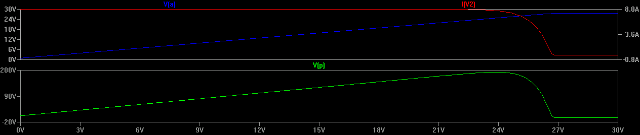

    I am attaching the schematics digram for the charger and two captures.
    I am sorry : it is hand drawn. I am not an electronics expert nor a software man !
    This morning I have activated the delay as suggested, I am waiting to see the results in the next days.
    The whole device works well and the MPPT is tracked well too.
    Thanks for all.
    regards,
    Ambrogio

    i woluld like to attach a photo of the LCD and a screen shot of the output.
    I am not able to attach any .jpeg : any direction for me ?
    Ambrogio
    3,154
    Default Re: MPPT solar battery charger
    Test attachment using picture icon on posting toolbar:
    Last edited by Demon; - 1st May 2014 at 19:01. Reason: removed pic, no longer necessary
    Jun 2008
    Varese , Italy
    326
    Robert,
    they are here.
    Ambrogio

    Hi iw,
    I'm impressed of your work.
    I played once with mppt converters and i know how crazy is.
    the attachments show dc simulation of 21V@8A photovoltaic. May be will be useful for you. I have dozens simulations of buck, boost and sepic converters, but i didn't finish the work because the 'client' give up. Now i have 3kg prototype but no panel to play
    Allow me to ask you what mppt algorithm you use ?

    Thanks iw,
    I suppose the first chart explains your code. I found it in the net. But i'm still out of focus.
    Why is the measurement of dV? As is shown on the simulation, the voltage of the panel
    is almost constant up to 90% of available current. So there is "constant voltage" and "constant current" methods. The voltage remain the same even at night, of course with almost no load. The photons flow become electrons flow, i.e. available current. So the panel is kind of current generator.
    And of course, measured dV will be small and inaccurate, may be the noise is from there.
    I used hardware circuit similar as algorithm in second chart. So i'm interested of your work. I will try to find my circuits, but unfortunately they are on almost dead HDD ...

    ok, i answered myself. I did simulation again.
    The voltage have little change indeed and can be used to determine the direction of duty. But this can be done without this too.
    Iw, if i find some time i will make Proteus simulation with your code.
    Will be nice to check some other algorithms before the fire of soldering iron
Size:  32.1 KBName:  pv02spv.PNG
    PS I don't know how to resize the images, sorry
