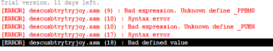

    ok, this is what i got so far, all i really did was to turn TRISA into inputs and slightly modyfied the code to what i think would work with the 4 buttons but without the axis. and i get this errors.
    MY code;
    DEFINE OSC 48
    DEFINE LOADER_USED 1
    include "DESCUSBTRYTRYJOY.asm"
    TRISA = 0
    USBBufferSizeMax con 1 ' maximum buffer size
    USBBufferSizeTX con 1 ' input
    ' the USB buffer...
    USBBuffer Var Byte[USBBufferSizeMax]
    USBBufferCount Var Byte
    ' * main program loop - remember, you must keep the USB *
    ' * connection alive with a call to USBService every couple *
    ' * of milliseconds or so... *
    usbinit ' initialise USB...
    ProgramStart:
    USBBuffer.0(0) = porta.0
    USBBuffer.0(1) = porta.1
    USBBuffer.0(2) = porta.2
    USBBuffer.0(3) = porta.3
    gosub DoUSBOut
    goto ProgramStart
    MY ERRORS;
    thanks for any advice
    Default Re: dummie joystick guide problem
    Darrel's usb routine:
    http://www.picbasic.co.uk/forum/show...0434#post80434
    Where did you get that include file? What are the contents?
    Someone has mentionned problems with Easyhid and PBP 3. Check out Darrel's usb routine.
    Hmmm apparently my last post on this thread didnt upload....
    ive spent the last few days trying to figure darrel USB routine (thanks by the way) but its only for PBP2.6
    where can i get PBP2.6??

    Hey there Demon. I foud a solution.
    You must place your project files inside USB18 folder (no sub-folders) in order to compile. I know that it sucks. But at least it workss!!
    Awesome!
    Gonna link back to here in that thread.
    Quote Originally Posted by jsags1 View Post
    I bet there's a way to figure exactly which file is needed in that folder and copy that one in the project folder (along with all the other files).
    Apr 2014
    21
    yes, ill try and make some time to figure out wich files are needed in the project folder after im done with my project. im on tiral version and only have 5 days left!!! XD
    thanks for the advice Demon
