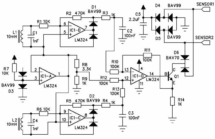

    I build the following wire guidance sensor succesfully
    http://www.philohome.com/sensors/fil...uide-schem.gif
    I removed the D4,D5,D6 part and put a pullup to +5V on the collector of Q1
    This is giving me a fine DC voltage according to the position of the wire to the 2 coils
    So far so good

    ADCin 0 has the wire guidance sensor as input (which is the wire sensor)
    There are 2 sensor signals on the schematic, but the code only checks one ADC signal?
    Does defining it as a sensor light do something special?
    Why not just ignore that code, use a PBP ADC sample program and use 2 channels (left and right sensor). Check the level of the signals and react accordingly?
