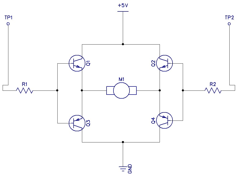

    The PIC is on an EasyPIC5 development board, but basically this is the schematic. I've also tried replacing the LDR with a 10k pot and whilst the LED on the dev board dims in brightness the threshold values still have the same effect. Placing the LDR between +5 and GPIO.0 gives a better range of brightness in the LED (not shown in the schematic) from off when the LDR is covered, to bright when an LED torch is placed directly over the LDR.
    I don't program much, so often feel like a newbie when I dust off the development board, and ADC is something I've only once played with. As far as I can understand, the voltage on GPIO.0 should be converted into a byte value between 0 and 254, so I could set the threshold at which point GPIO.4 is made high ?

    Shouldn't there be protective diodes "somewhere" whenever a motor is used?
    I don't really get how that motor is wired. I would expect a pulse method, but the code is constant on for 5 seconds.

    Robert,
    I grabbed the h-bridge circuit from a web site, which using pnp / npn transistors works ok for the test motor (see above). I will be using an H-bridge chip for the larger motor.
    Yes for testing I have the motor running for 5 sec once the threshold has been breached

    I think you need a voltage divider network for the LDR. As it is the voltage on your ADC input line will always be 5VDC.
    I also wonder about the capacity of your transistors. The stall current on the some of the motors I found was 46 Amps. If the motor were to stall, your transistors would burn out with unknown consequences. If you want to use this motor I'd put a fuse in the supply line to limit current during stalls.
    Typically motors make alotta noise when running. I think it's a great idea to separate the power supplies. Just make sure to make the low side connected between the two systems.

    Check the risistence of your LDR in both condition (dark and light). Since the lowest resistance should be found in light, use this value for your devider network. In this way you should have a value in volts near to zero in dark and near to Vdd/2 in light, more than enough to be sure to trip the system at the right time.
    By the way the schematics of your Hbridge is wrong! NPN should be connected on the low side, while PNP should be connected on the high side.
    Follow the wise suggestion given above, always use freewheel diodes when using inductors!

    Al,
    My fault, I drew the schematic the wrong way round (I was rushing ). I've now placed diodes between the collector and emitters of each transistor as suggested.

    Default Re: 16F690 - code working - brain freeze on schematic !!!
    Guys,
    I've been resting my code using a DC motor driven by a simple transistor circuit as per attached which works well, with the intention of using a double pole change over relay to switch the polarity to the motor (throw off from my old model railway days as that's how we used to make the loco go backwards or forwards). The think is I can't get my head round how to use the transistor to turn the power on / off.
    I came up with the attached, but not sure if this would work, or if I should have the transistor between the relay and GND (ie C to relay, E to GND). I've left the Diode out as the motor is bi-directional
    Advice welcome before I blow up a handful of transistors trying
    I use this for motor driver:
    Thanks you..
    3,612
    Default Re: 12F683 - basic code not working
    Regarding your first schematic, generally you need to put the transistor on the low side. Otherwise you need a higher voltage on the base than you've got on the collector. Put the relay "on top", then on to the motor and finally the transistor at the bottom, emitter to ground. Yes, the motor is biderectional but the current thru the transistor is always the same so put the diode back across is, cathode facing "up" of course.
