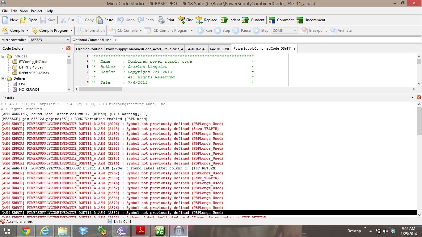

    I'm having a strange problem when using PBP on my new laptop. I'm away from home now, and don't have access to all my resources.
    I can compile using PBP (3.x) just fine.
    When I try to use the -n option for PBPL, the compile goes OK, but when it gets to the assembler I get the following:
    Name:  Screen Print.jpg
    What is setup improperly on my laptop?
    Charles Linquist
    Default Re: Assembler problem
    Hi Charles,
    I hope I understood the question . . . In MCS Click View, click compile & program options, in there the first check box should be checked . . . Use compiler long words. HTH
    JS
    Scroll down through the list of errors.
    Look for one that says "WARNING: Unable to open INCLUDE file ..."
    I'm guessing you don't have DT_INT-18 on that computer.
    http://darreltaylor.com/DT_INTS-18/home.html
    Or, post the complete list of errors.
    Tried it here without DT_INTS and it gives the warnings at the compiler level, not the ASM.
    So you'll need to post the complete error list.
