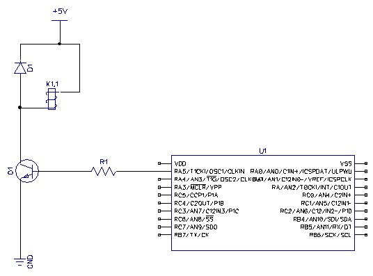

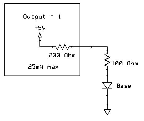

    In the datasheet I looked at the current gain for the BC639 is stated as minimum 40. Your relay coil needs 5V/63ohm=80mA at 5V, with a gain of 40 you need to push 80/40=2mA into the base of the transistor.
    There's a drop of 0.6V across the base-emitter junction so if the PIC is powered with 5V you're left with ~4.4V to do it. The base resistor then needs to be 4.4/0.002=2200ohm, I'd go with half that or ~1k.
    With a 100ohm base resistor you're overloading the output drivers in the PIC, trying to pull ~44mA from an output rated at 20mA. This is probably why the voltage is clamped to way less than 5V.
    Fit a 1k-2k resistor then verify the operation in steps.
    1) Measure the voltage at the PIC output, it should be either 0 or 5V (or close to it). If it's not then something is wrong.
    2) Measure the voltage at the base of transistor, it should be either 0 or 0.6V (or close to it). If it's not something is wrong.
    3) Measure the voltage at the collector of the transistor, it should be 5V when the transitor is OFF and close to 0 when the transitor is ON.
    If it doesn't work please do the above measurments and report the results.

    Fitted a 1.5K resistor
    1) - Voltage out when the pin goes high = 4.52v
    2) - Base of transistor voltage measured 0.73v
    3) - Voltage at collector when PIC pin was HIGH was 0.03v and 5.01v when PIC pin was LOW
    Still the relay contacts didn't switch.

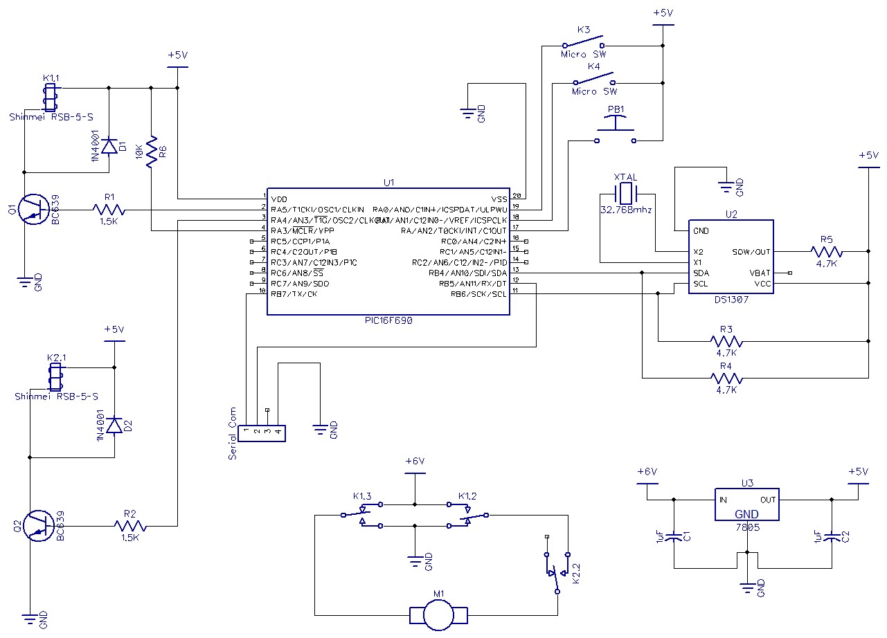

    Thinking it might be the regulator as I'm using a 200mA version of the 7805 I changed this for a traditional 1 amp version - still no change.
    As the new relays are DIL footprint (16 pin DIL) and I am using sockets, I removed the relays and inserted the pins of the original relay into the contacts on the DIL socket. This relay also has a coil of 68 ohms so would be drawing similar current of around 80mA ? - The contacts changed over just fine. Last test was to attach two wires to the coil and plug this into the DIL socket - still no change, but plugging the coil directly across the 5v switched it hard...
    I'm going to re-breadboard the hardware with the DIL relays and see if it switches OK just to rule out a fault on the stripboard (my eyes are not what they used to be - so I could have a dry joint or short somewhere !) - but I don't hold up much hope as any such issues should of resulted in the same thing happening with the original relay when tested with the stripboard.....
    Oct 2009
    583
    Default Re: 12F683 - basic code not working
    Its now working.
    I removed all the links to the relays apart from the coils - tested and it appeared to energise. I then googled the datasheet for the relays and found that the contacts where wired differently to the other relay (NO / NC then the comm rather then NO / comm / NC) - rewired the stripboard (now quite a mess) and it works (well I get 5v out to the motor when the pic energises the relays )
    Thanks to all who contributed - and I'll note that formula for working out the resistances - Cheers Henrik

    Default CCT diagram
    Well for reference and to aid anyone who may stumble across this thread in future here's the circuit diagram and final code (full of comments to explain how it works)

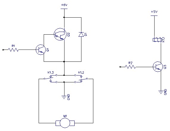

    Just for the fun of it, you may consider playing around with the relay and transistor separate from the PIC. There may be some possibility that a base bias resistor between 5k to 10K may actually switch that relay quite nicely. If so, that would put even less current demand on the output of the PIC. In the future if you are browsing a supplier like allelectronics, look for the 2n7000 N-Channel mosfet. It can handle 400mA and won't require any current at all from a PIC, since it is voltage driven. Just a 1 meg bias resistor holding the gate to ground. I bought a surplus box-of-em on ebay a while ago. Enough to last me the rest of my life ;-D
    Great pics my friend!! and a very well done project!!
    Congrats!!
    Duane :-]
