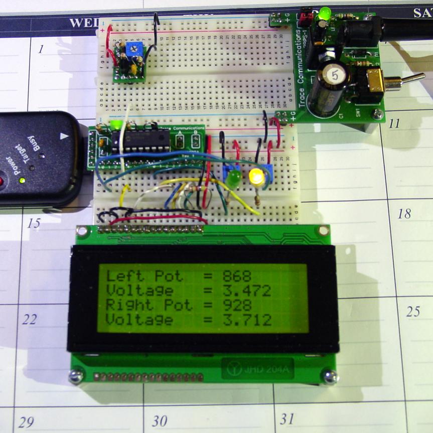

    Here's a picture of the LCD with the above displayed.
    Name:  PIC16F88 TL431A ADC LCD Demo (lo res).jpg

    Here's my code; it works. Thanks.
    ETA: I am using a 4.096V reference.
    ' Aliases and Modifiers:
    ' Program Code:
    PAUSE 1000 'Pauses 1 second to allow LCD to setup.
    start:
    ADCIN 0, left_pot 'Reads analog voltage on AN0, converts it to 10-bit digital
        'value, and stores it as left_pot.
    lpot = (left_pot*4) 'Multiplies left_pot times 4 to get 1000x voltage.
    ADCIN 1, right_pot 'Reads analog voltage on AN1, converts it to 10-bit digital
        'value and stores it as right_pot.
    rpot = (right_pot*4) 'Multiplies right_pot times 4 to get 1000x voltage.
    LCDOUT $FE,1,"Left Pot  = ", DEC left_pot 'Clears LCD screen, displays
        '"Left Pot = " and the decimal ADC of left_pot.
    LCDOUT $FE,$C0, "Voltage = ", DEC lpot/1000, ".", DEC3 lpot//1000
        'Displays result to 3 decimal places.
    LCDOUT $FE,$94,"Right Pot = ", DEC right_pot 'Sets LCD to beginning of
        'second line and displays "Right Pot = " and the decimal ADC of
        'right_pot.
    LCDOUT $FE,$D4, "Voltage = ", DEC rpot/1000, ".", DEC3 rpot//1000
